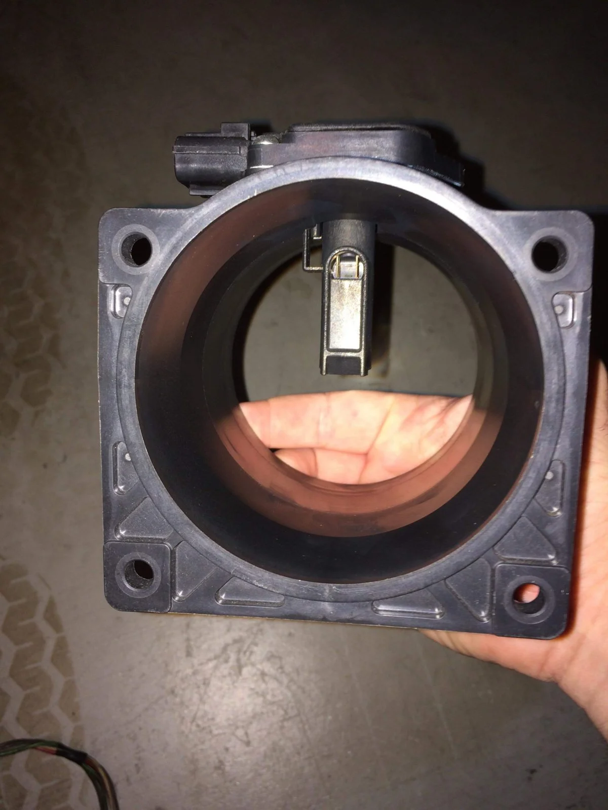

So do I just cut the flange off so it fits in my bbk cold air intake where the stock one is

Wasn't a pretty sight...and I've got big hands

They sell a bolt on adapter at most local parts stores. It in the area with the cold air intakes. The adapter just bolts on.

https://lmr.com/item/JLT-MA8090/199...erm=4585100928499983&utm_content=All Products

What computer are you running? Stock?

I didn’t know they had that. Wow that price though I got the meter for 40. Yes I am using the stock ecu

You are not able to use that mass air with the stock ecu

You need a tune to run that meter.

That meter is way more trouble than it's worth on a foxbody.

That meter is the one I need for my car.... but i have a stand alone pcm.

Thats the meter i use on my car, but i have a standalone pcm

MAF interchange for 93 and earlier Mustang.
Swapping the MAF sensors between different MAFs is a big no no. The MAF body and sensor are designed to match each other. Therefore you can't swap sensors between different part number MAF bodies and maintain proper calibration. The assembly is designed to match the computer’s internal program, and swapping a different MAF can upset the computer's calibration. In other words, your monster MAF probably won't match the calibration of your 5.0 Mustang computer.
The OEM Ford MAFs are not calibrated to injector size. The injector sizing is done in the computer’s internal programming. Aftermarket MAF’s “lie” to the computer in an attempt to fool the computer into changing the injector pulse on timing to match the increased airflow.
The exception to the above statements is if you have an aftermarket tuner system such as Moates Quarterhorse, Tweecer, or similar device. Then you can alter the computer's MAF transfer function table to match whatever MAF housing and sensor you have. The tuner device works in conjunction with a high quality Air/Fuel ratio meter so that you can tell what sort of air/fuel mixture you have a any given time.
The only other MAF that is a one for one swap for a 93 and earlier 5.0 Mustang is the 94-95 Mustang MAF.
94-95 Mustang GT MAF - $40-$100. It is 70 MM instead of the stock 55 MM on regular stangs built prior to 94. It uses a slip on duct on the side that goes to the throttle body and a 4 bolt flange on the other. You need a flange adapter to fit the stock slip on air ducting that goes to the air box. Wiring plugs right in with no changes. *1 *2
Once your replacement 70MM MAF is in place, disconnect the battery for about 10 minutes. When you reconnect the battery and start the engine, the computer will relearn the settings for the new MAF.
