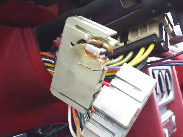

check for power out of the headlight switch. if good, go to the multi-function switch (turn signal switch). the MF switch connector likes to burn up (esp if you have a gt with fogs). sometimes the feed wire will pull out too. it is red/?? as i recall.

this is what happened to my switch
