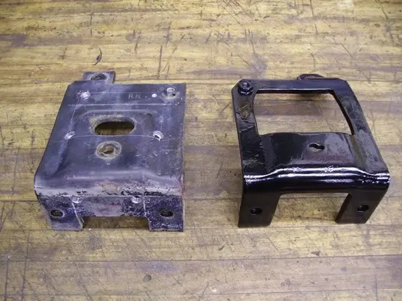

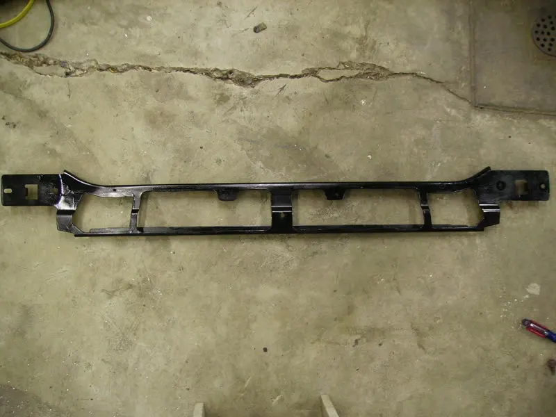

Got bored on afternoon and did this:
Saved a few pounds. The brackets are 1/4 steel! I can't believe Ford made them that thick.
You need the center piece, the bottom of the rubber bumper cover bolts to it, otherwise it will flap around. I cut out the center and saved another few pounds.

Did you weigh them before and after? That would of been interesting to know how much you saved.

I thought about cutting holes in them too, I dont think you need that support bar, the Cobra R didnt have it.

The Cobra-R didn't have foglights. It is there more to support the fogs than the bumper.

I did not weight them, but it could not be more than 5 lbs lighter. Every little bit helps though. There has to be some way to support the bottom of the bumper cover, otherwise it would just sag. There are four bolts that go through the cover into the center brace. I like to see how it's done on the Cobra R.
