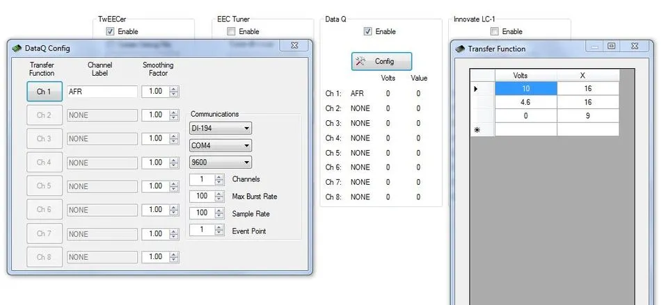

Ok. for those that would want to know. I got the answer for my question from the developer of the BE software. He said that its not possible with the A9P EEC. His recommendation was to get a DATAQ DI145. it gives you 4 more ports to data log with and its only around 30 bucks. Not sure how to make the DATAQ & BE work together just yet but I will work that out later.
I use the DataQ for my wide band and it works good.
Get the drivers installed for the DataQ and go through their calibration instructions.
You need to note what COM port your DI145 uses so you can input that into BE. (note: always use the same physical USB port on your laptop for the DI145 or your COM port will be different.)
Setup the transfer function for your boost sensor and I think you use "boost" for the Channel Label
This is under the "Hardware" tab.
