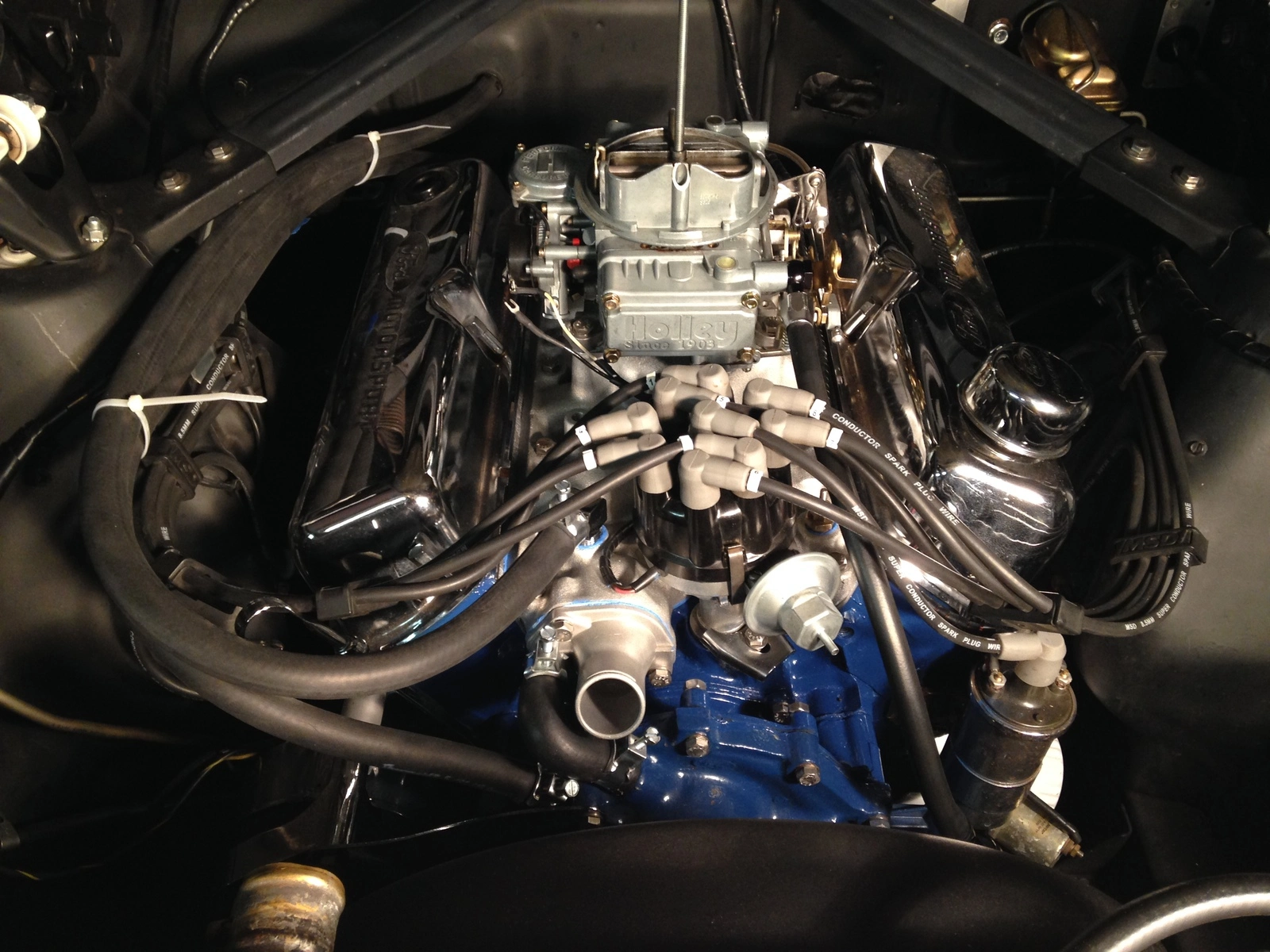

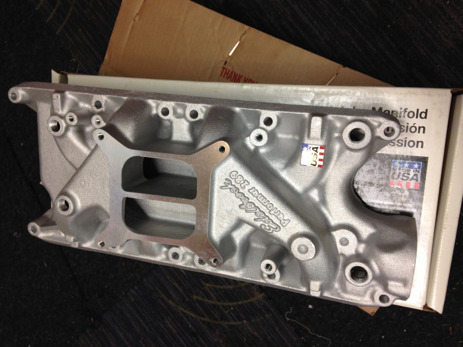

Engine was rebuilt 10k miles ago. It already has an Edelbrock Performer Cam and a new Holly 4160 Carb. Now it will have a new Edelbrock Performer Intake.
Nice add! I'm interested in your thoughts on the Holley 4160. Does it perform well? Thinking about the same carb for my build.
the 4160 series holley carbs are good ones, but they are jetted somewhat rich out of the box for most combinations, so be prepared for a rejetting exercise. imo the edelbrock performer carb is a better street carb than the holley.

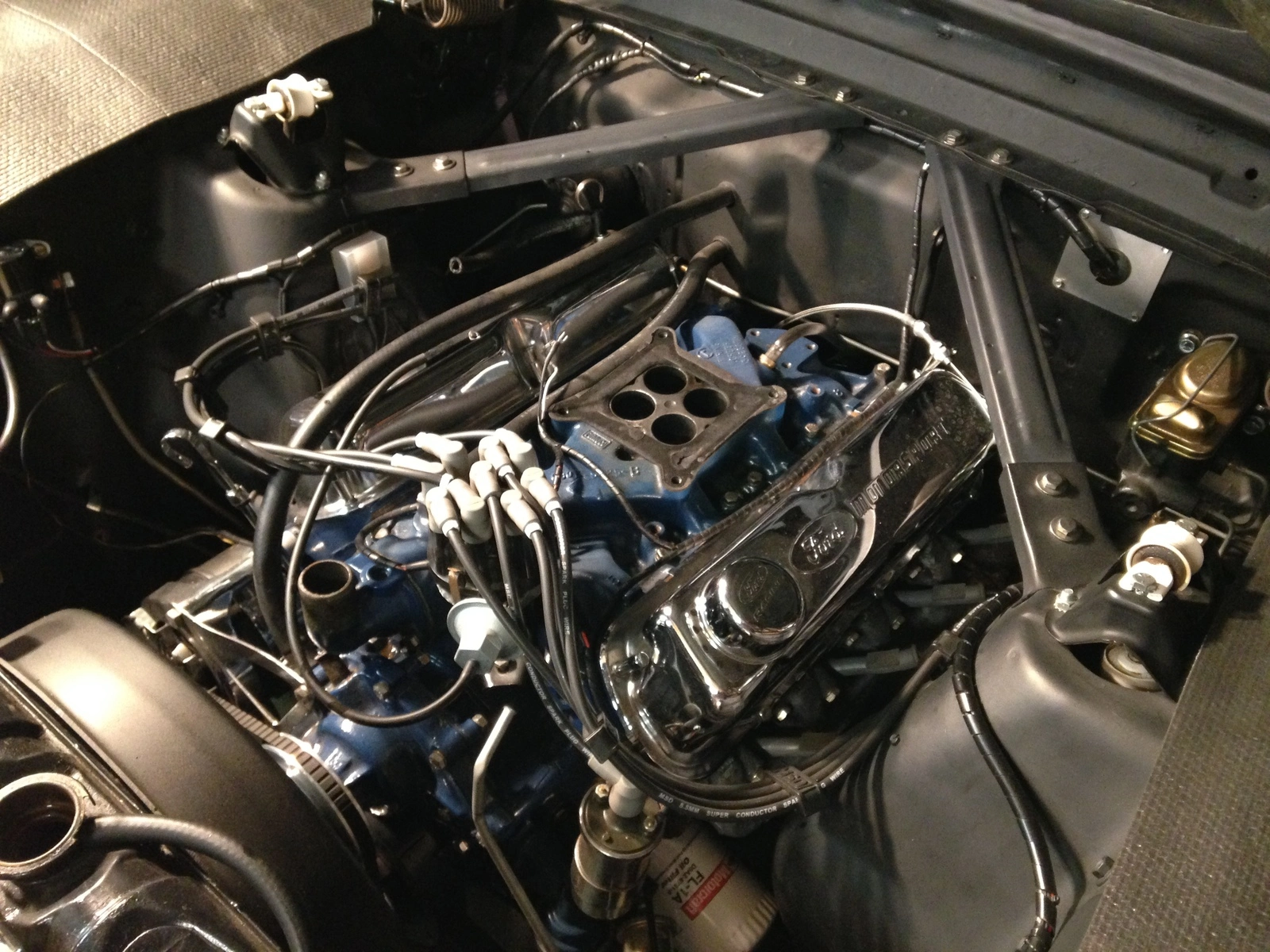

Intake install complete. It sure does take a lot longer when you clean everything before you put it back on. Runs great. The motor definitely feels like it runs much more freely.
Before I added in the antifreeze I flushed the system. (Big mistake.) Now I have to change the heater core and radiator due to leaks. :notnice:

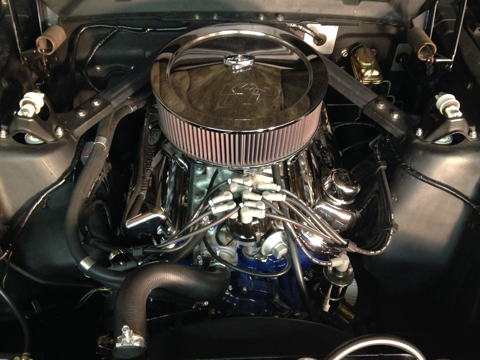

Here's a completed picture.
