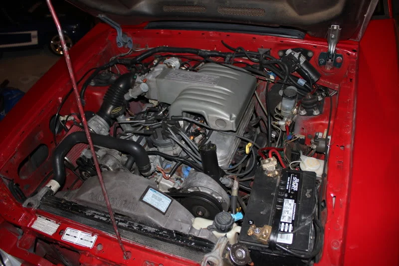

1. The brakes were converted to 5 lug, but the e-brake isn't hooked up to anything and I need to make it work. I haven't crawled under the car all the way yet as I am tired, but likely will tomorrow to see if the cable is still there.
2. The guy lost the keys to the car and just has a replacement ignition set in there, I need to get it re-keyed to all match... Can a Ford dealer get me that based on the VIN or call a locksmith? And yes it has a clean title, and yes the VIN matches, that concerned me but It appears to be fine.
3. Blinkers don't work... the hazzards do but the blinker doesn't. I am no NOOB to troubleshooting :poo: like this, just wanted to see if this was common before I go through the whole process?
4. I need a drivers-door arm rest cover... what is the best/cheapest place to get those parts? (http://www.latemodelrestoration.com)?
5. The radiator fan is missing a blade, and the radiator is pretty beat up... It drove the 4 hours home just fine and never got hot, but I want to replace them before it becomes a problem... Radiator and fan suggestions?
Post pics of what you find and it'll be easier to tell what you need.

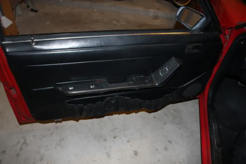

Probably.
I have a Northern radiator, or whatever they are called. The Misimoto radiators seem to be nice for the price too. Fans is a broad topic. Many people use a single Taurus fans with an aftermarket controller. I have some LS-1 fans which was an exact fit on the radiator, and they move some air, for sure. I also got a controller from eBay for $25 and it works great, adjustable thermostat and all. Make sure to upgrade to a 3G alternator too.

Nice find! Very sharp coupe, but I'm partial to coupes as I have three currently. Lose the wheels for sure. Wrong offset on the back and I'm not much of a fan of the prostars anymore for some reason.
As for radiator, get an aluminum 2-1" cores, as for fan, the stock setup can't be beat, but for a no hassle install, the Extreme Black Magic from flexalite can't be beat imho. I've installed quite a few and they pull some air.

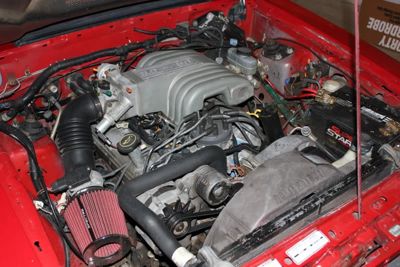

Combo sounds great, get rid of the cone air filter on the stock maf, that's just an idle surge waiting to happen. Get an Anderson PowerPipe or something equivalent, stay away from mac and bbk cai's they are a pain to tune and get the idle right once you get more mods done.
Your ebrake cable is going to be a pain since you have rear disk brakes. Ford has discontinued their rear cables, but I believe the front cable is still available for rear disk conversions. Good news is Stainless Steel Brake Co. has the three cables you need to make it work. Also, search the net for "Rear Disk ebrake modification" and you'll see wha tyou need to do to modify the ebrake handle to make it work with the rear disks. I have a coupe with rear disk conversion and the ebrake works perfectly. I had all the ford stuff sitting on the shelf from where I ordered it years ago, so it was a smooth swap for me.

I don't know what your plans are but you have a nice car that you could make into a 6-8k coupe easy. The arm rest can be fixed with a new pad from LRS or ebay/ junk yard. Any seat from 79-2004 will bolt right, black seats from a 1999-2004 will be the easiest and cheapest, I would take that carpet out and either power wash it or replace it, looks like it needs new door moldings. You can probably have that thing all cleaned up inside for 400-500 bucks.

If it was mine i would put the a/c back on and find a stock air box. You'll never sell a 5.0 quicker when the it all looks stock and maintained. Very nice vert and good investment in the mustang world. Post up some pictures of what rear end was used for the swap and someone will be able to figure out how to get the parking brake hooked up
