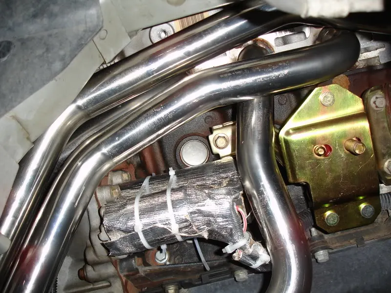

Its also a good Idea to wrap your starter In some kind of heat shield. I learned this the hard way on my old car...
And for all of you that said the zip ties would be gone in a week- a year later and they are still holding strong
