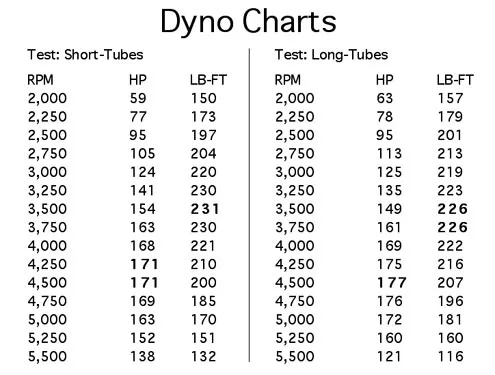

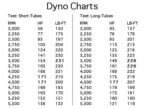

Everyone has their own claims of what their headers did for them. All different cars. Different mods. Different tracks. Different dynos. The guys with shorties say the shorties gave them great numbers. The guys with longtubes say their headers gave them great numbers. Can the claims be compared fairly? How many here actually have numbers from both headers back to back?
These guys do.
ST vs LT
http://www.mustang50magazine.com/techarticles/29618_short_long_tube_headers_test/index.html
In the end, everyone will believe the numbers they want to believe. Will those numbers be worth the effort of the installation? We can't come up with an answer for everyone. The effort to install headers differs from person to person. The reason for installing headers differs from person to person.
For me personally, the effort to install either are about the same in my view. What decides it for me is that shorties cost less and I do not have to get a new midpipe. That, in my book, is $300-400 I don't have to spend for an extra 10 hp above 5000 RPM. I'm not planning to do headers to shave off some time off my ET. My car is a daily driver that has been seeing less and less of the drag strip and more and more of an autocross track. Top end hp is not as important to me as it might be to others. An extra $300-400 for 10 hp is not worth it in my book. For me, doing the research, shopping for the parts and installing the mod is where it counts. I'm a hobbyist. Not a die hard drag racer. :)
This is where i feel the same! :nice: Plain and simple.And by judging by the chart you posted,in the range where most of our stangs run,there really isn't a huge difference at all between the two,not enough to cough up that extra coin inmy books.But now,if i was a weekend drag racer doing it for coin,and compatition,then yeah,long tubes it would be as they really seem to help out the top end rpm's!
It seems though that the shorties seem to help out the torque where it matters on the street for a daily driver. ;)

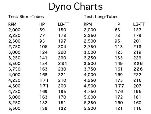

That chart is from a 302 motor not a modular. Sorry but the results are not the same. You will gain very little hp with shorties but you will gain a lot with LT's throughout the powerband.
It is bad when a Header manufacturer won't make shorties because they even state the gains are too minimal to even waste their time making them. This is the first site that has people claiming shorties are better than LT's, yet every other site is different.
