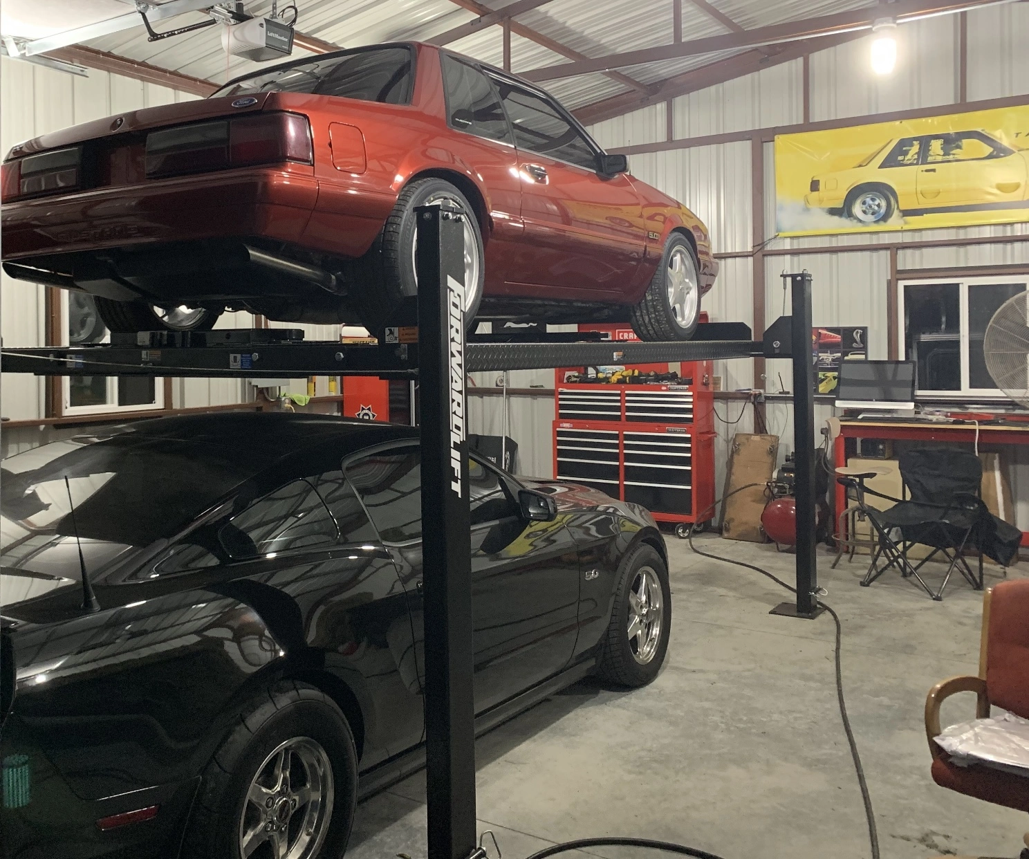

Thanks for the input. I have a 4 post lift with rolling jacks. I figured we would try to do it on the lift. I also have some raceramps and jack stands too How high are you talking?

Oh, if you have a lift you're golden. Not many of us are so blessed to have one for this project and have to do it on the ground

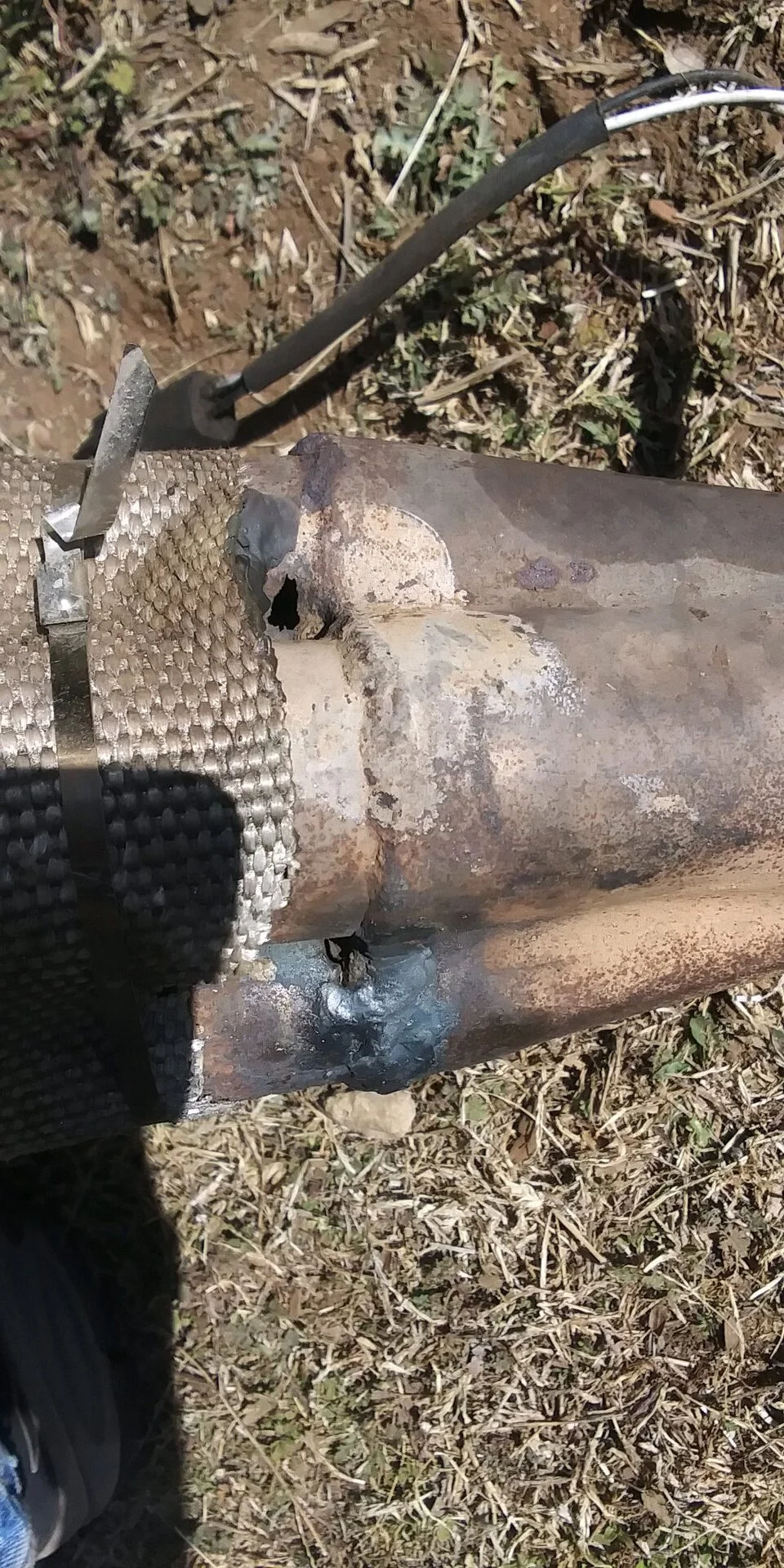

The new BBK longtubes are in, thanks for the tips. He already had the small starter. This picture is of the old longtubes that were needing replaced, more than just pin holes. Leaks were causing screwy readings from O2 sensor on that side. I had tried to weld some of the holes, but could not get to them while in the car. And they were entirely wrapped in ITCHY fiberglass
