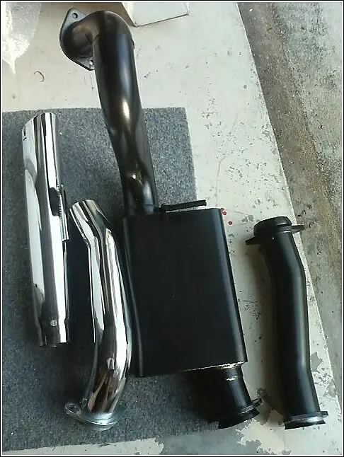

The sound won't be huge, don't change from shorty's to LT's for sound. I found LT's to be an easy header to install over shorties (have the option to come from the bottom), I've put 2 LT's exhaust systems on my car both by MAC (like mentioned above, love raspy sound of the Prochamber), also installed MAC LT's on my neighbors car in about 2-3 hours.
Ceramic Coated 1-3/4" by MAC for the win, I would never buy anything but ceramic after these, they never discolored.
3" Prochamber by MAC. The sound is amazing.
3" Cat Back by MAC. With the Prochamber and this cat back, nothing but compliments.
