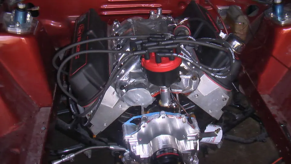

If i make it in the tens, it will be one of the coolest things ever. Iv been waiting so long to make a good pass in this thing, and it seems stuff just keeps going wrong. Tens have been my goal since i built the car and iv yet to accomplish that. Iv been soooooo close 11.20 is real damn close, but not close enough. Im hoping sometime this week i can meet and maybe exceed my goals.

Dude my combo is alot milder than yours and I plan to go high tens on motor on my breakin passes. Depending on converter if you hook and leave on the brake you should go 10.40-10.60 easy.

There is alot of things that i have to work out of the car, still testing and tuning it. I made some passes tonight, fastest of the night was an 11.04 @ 122 and they shut me down because I didnt have a fire jacket. I had to make 1/8 mile passes the rest of the night. I think the suspension is all wrong but we will see.

If you can list all ur mods engine specs, trans, susp, weight.
Thanks
Engine
1969 351w Block
Bored .040 and Stroked to 410
Probe Forge Alum. Pistons 4.040"
10.3:1 Compression Ratio
4340 Forged Crank 4.00" Stroke
4340 Forged H-Beam Rods
AFR Aluminum 205cc Heads
-Upgrgraded springs to handle .710 Lift
Victor Jr Intake
QuickFuel 750cfm Carb
MSD Pro Billet Distr.
MSD 6AL, MSD 2 Step
Hooker Super Comp Longtubes
-2" Primaries w/ 3.5" Collector
Suspension
Front
D&D Tubular K-Member
D&D Tubular A-arms
Strange 10 way Adjustable Struts
Stange Coilover Kit
QA1 110# - 14" Coils
Weld 3.5" w/ MT ET Fronts
Rear
Mini Tubs
Baseline Suspension Offset Double Adjustable Lower Control Arms
Baseline Suspension Relocated Double Adjustable Upper Control Arms
Baseline Suspension Anti-Roll Bar
Strange 10 way Adjustable True Coilovers
QA1 105# - 12" Coils
Weld 10" w/ MT 10.5Wx15
I think thats everything, if you need any more info let me know.
-AJ
Dude to be honest our combo is almost identical except I have alittle more comp bigger carb and 1 7/8 longtubes but I'm also in a coupe. So trust me there's more in this combo and we both could benefit from a super vic and a bigger carb (in your case)....:nice:
