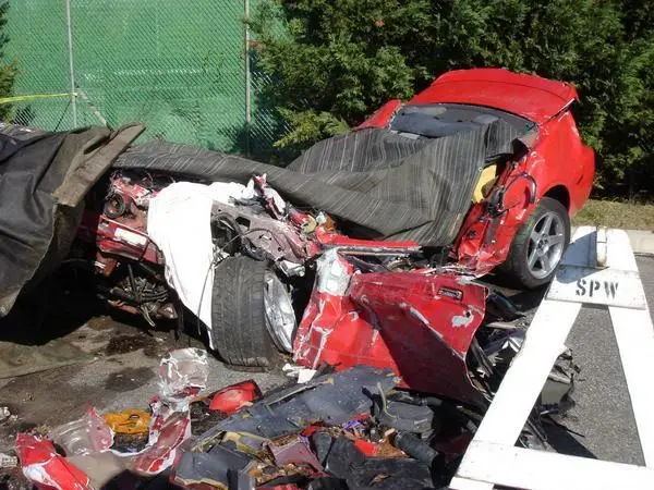

Not to rain on the parade or anything, just make sure your son can respect the power of the car. I know its not the fastest thing in the world but I've seen some kids do really stupid things with fast cars because they are young and stubborn about knowing when and when not to mess around with a fast car. A kid I know sold his 04 Cobra to an 18 year old kid and like six months later, the kid ended up showing off in front of his friends going over a hill in it and killed himself and the person he hit. The kid was going 110 when he went head on with the guy. Here's the aftermath of the accident.
your a kid yourself, if i recall, so why are you trying to start drama where there is none. Every body who has a fast car as kid ,is gonna azzhole around on the street every so often, its when and where is what differentiates them from the rest.
Im 22 in a month. I dont refer myself as a "kid" anymore. I did some stupid stuff when I was 17/18 but through college and other personal experiences, I feel I've matured a great amount since I first got my licence. I'm not trying to start drama at all, I just hate to see these 17 year old kids get a car and not respect the power and end up like the cobra.
