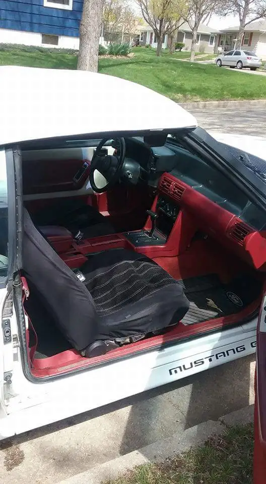

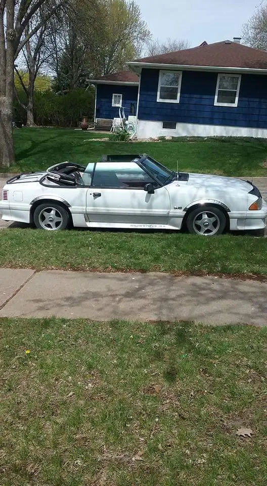

They are asking 2000, car looks clean. Says all it needs is a passenger window motor, and the exterior door handle. Car has 165,000 miles. All stock.
My questions, is it worth 2k? Also what are some hot problem points to look for.
Thanks!

Provided no significan't rust or underlying damage, it's probably worth $2K. Cleaned up, tint removed, fender trim removed, bra removed, with a good wash, buff and wax and interior detail, it's probably worth a bit more.
I'd take a peek under the fender trim that was added on and see if there is any rust forming there. Those flares were a thing about 10-15 years ago and many used them to hide rusting fender lips.

$ 2K sounds like fun for V8 power. Looks like the windows seat up well on passenger side & the top must work. Looks like Midwest car? Might be some rust behind those fender wells with those beauty salt catcher fender skirts if they drove it on the Winter? Rack & pinion might need some Lucas to slow down seeping.

check for rust in the shock towers, torque boxes, and truink area. You didnt provide any pictures of the engine or front of the car. $2000 is a decent price as long as nothing major wrong with it, but know that its a 30 year old car and you will be fixing things regularly.

Get a look under the car, look for cracks in the floor pan at the rear seat bolts, floor rust in the foot wells. Open the doors and look at the door hinges where they bolt to the body and at the base of the windshield posts. Another place to look for rust is where the cowel and the firewall come together and around the hood hinges.
