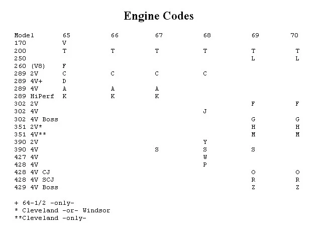

I was also wondering if anyone could explain the various model codes. I keep seeing adds refering to a C or A code. What does this code mean? Are there certain codes that are more desirable?

Here are some engine codes browed from another site:
Model 65 66 67 68 69 70
170 V
200 T T T T T T
250 L L
260 (V8) F
289 2V C C C C
289 4V+ D
289 4V A A A
289 HiPerf K K K
302 2V F F
302 4V J
302 4V Boss G G
351 2V* H H
351 4V** M M
390 2V Y
390 4V S S S
427 4V W
428 4V P
428 4V CJ O O
428 4V SCJ R R
429 4V Boss Z Z
+ 64-1/2 -only-
* Cleveland -or- Windsor
**Cleveland -only-
Yes, certain codes usually bring different prices.
Well, that worked great. Let's try it again.
<img src=http://forums.stangnet.com/attachment.php?attachmentid=42955&d=1140925176>
