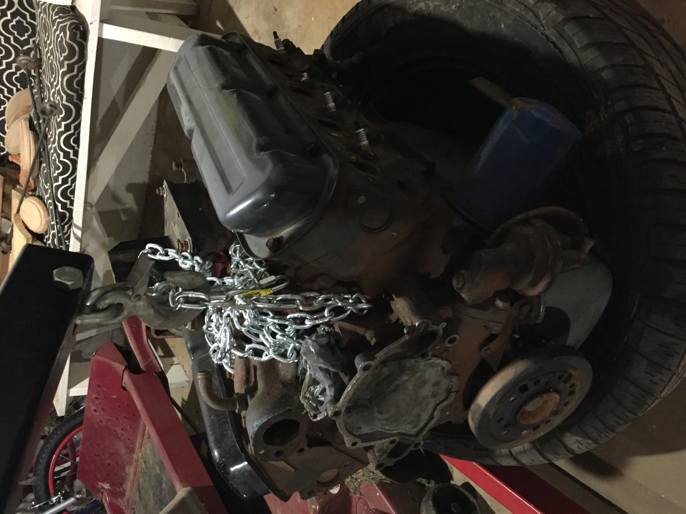

the 351 used the same heads as the 302ho engine in the mustang. if you want oem iron heads look at a set of explorer heads [gt40 style] they are a marked improvement over the e7. The intake manifold will play a large role in how much potential the engine will have. maybe post some pictures of the stuff you have already acquired. what are you going to tune this engine with??

From what I've read and bench flow tests they 69 351 has that I have now can't hold a little bit bigger valves and flow just as good as GT 40 heads. My goal all motor is just to get this 351 to 400 hp while keeping everything looking as dark as possible whether that be to use a 393 stroker kit or a 408. Currently the 351 that I have it sitting in my shop floor and I was an import guy so I have no clue as to the tuning. With all of my imports it was chipped the EC you take it to the Dyno and let the man tune it
Clean slate
