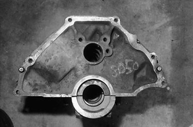

A couple of ideas
1. On some old blocks there is a pin that used to hold the rope style rear main in place and if it is in with the 2 piece seal it will leak lots.
2. Back of block has oil galleys and a cam plug and one of these could be it.
3. Wrong flex plate imbalance
4. Don't use intake manifold end seals on ford small blocks, just use silicone on both ends
5. your sure its not trans fluid leaking. ( I know it sounds dumb but both motors leaking the same?)
6. maybe do a dye kit to see where it is leaking from. you said rear main leaks but also said it was good.

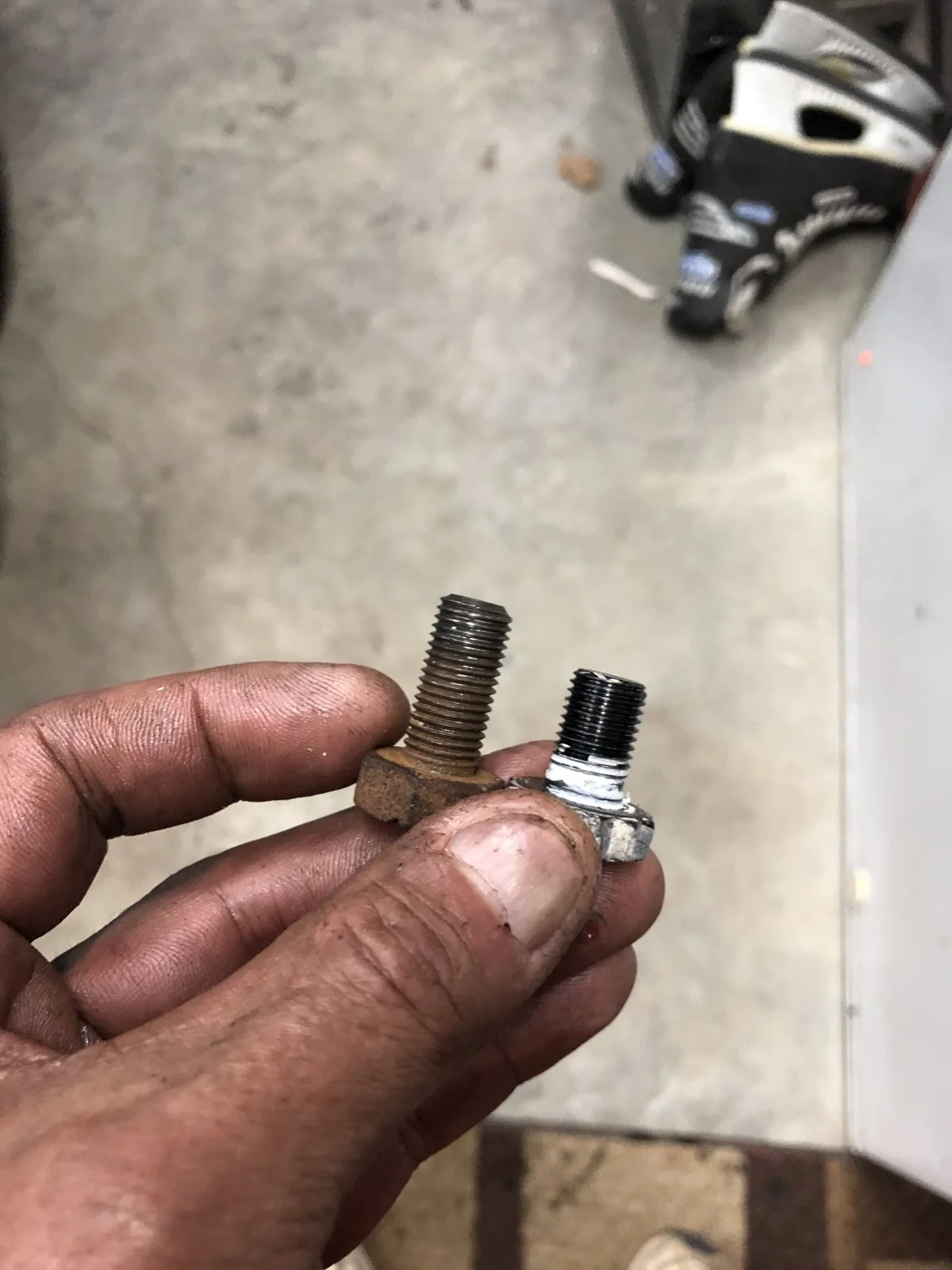

So here is an update. Leaked again after new seal etc again. Last resort I’m thinking the arp bolts are causing the issue. Never had the original bolts with new engine so we purchased arp bolts to install. Sounds to easy, called arp and they said it’s not an issue. but it is something that was installed on original motor and carried to second motor. Thinking shoulders or something is different to cause it. Will pull tranny tonight and put original bolts in that I have rounded up from a guy. Sounds to easy because you’d think that much oil couldn’t pass through. Arp bolts fit nice and torqued proper but it’s the only thing left. Will post tomorrow on the results and if this is what the issue was I hope it helps someone in the future as this has been a nightmare.
No all where thread sealed when put in. Maybe arp bolts were packaged wrong who knows but they are getting tossed into garbage if this was the cause of this. Will know tomorrow after I change them back to original bolts.
So here is an update. Pulled tranny back and changed bolts. After pulling the first bolt out this is what I found. Pic at end. So I’m thinking the bolt from arp isn’t long enough to close off oil flow in crank???? Let me also say that while the first motor kept leaking I had phoned arp and asked them if the bolt might have been an issue and they flat out said not a chance, so we looked elsewhere to find the problem. Not having the original flex plate bolts to compare the new arp ones to we were assuming they are right. Checked with parts store and they said right part number but maybe a possibility of a miss package on arp fault who knows. So started it up tonight and leak has gone away. Who would has guessed. All the bs for 6 friggin bolts!!!! Well I’m closing I know I can change a rear seal and pan gasket in 25 mins laying under car and re and re tranny in 45 min lol. Practice make you faster. Thanks for all input guys and hope this helps someone out that runs into this issue.
