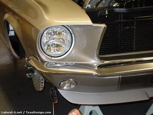

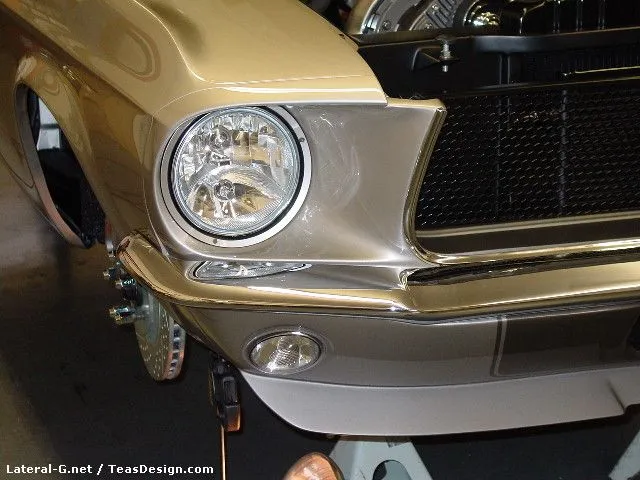

I'm looking for source for City lights on my stang, like these on Fastforward....
any help would be awesome!
