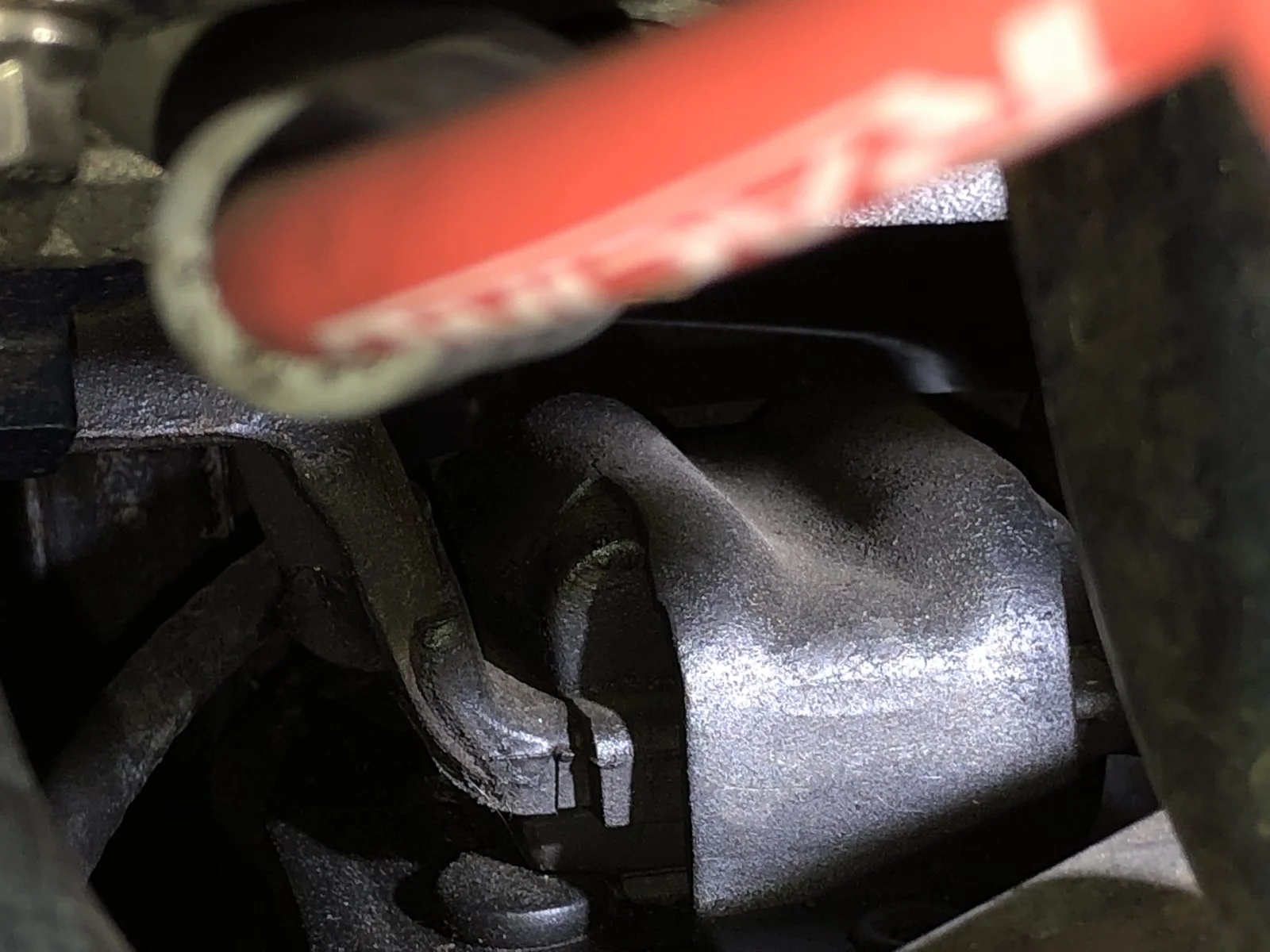

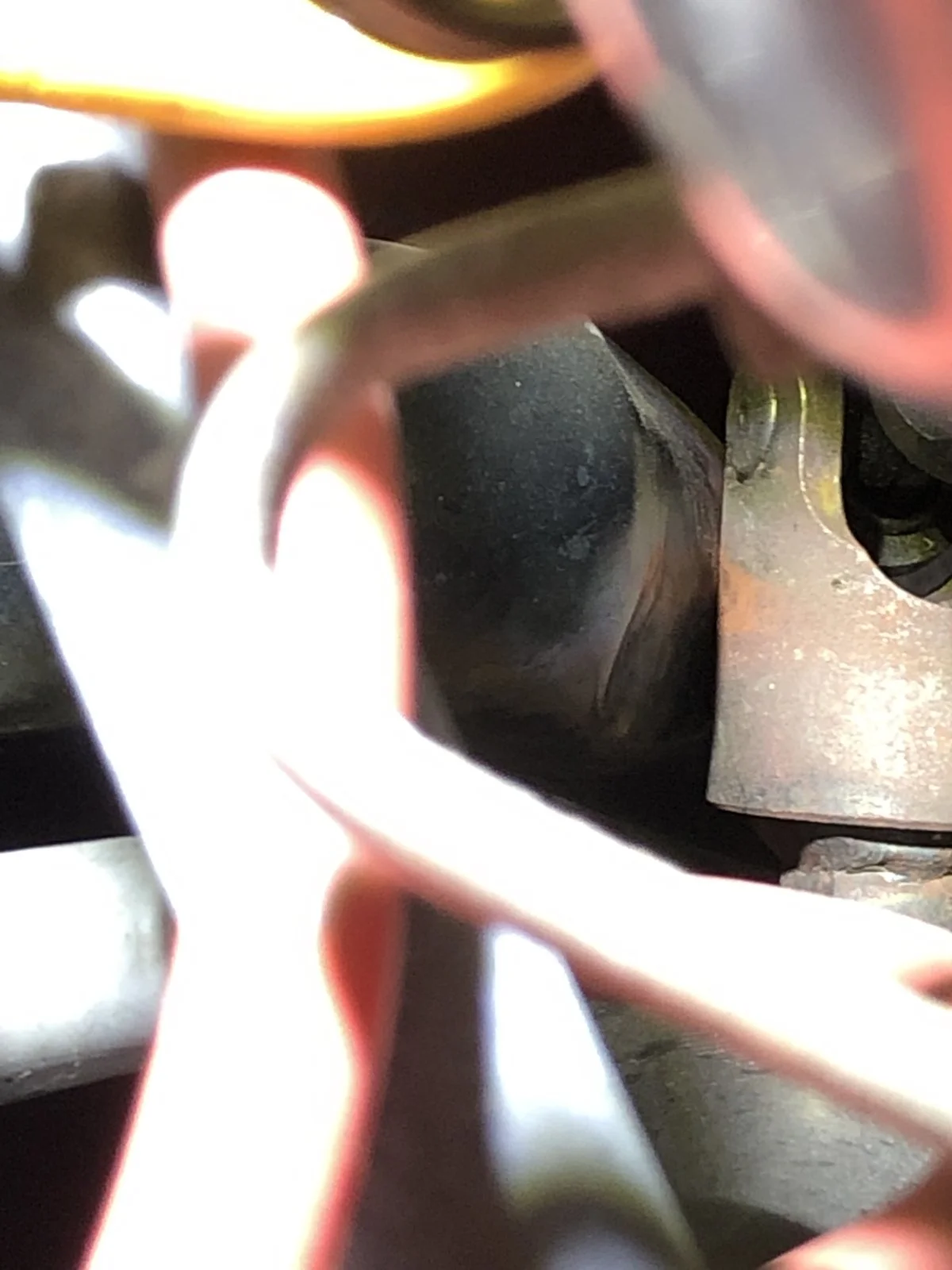

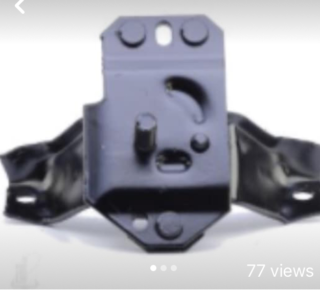

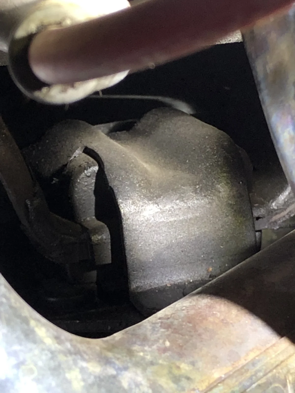

Engine Looking to raise motor a bit. Are these stock 89 Fox coupe or convertible motor mounts?
Are these stock or convertible mounts in my ‘89 coupe? I’m looking to raise the motor just a bit for some clearance between the BBK LTs and MM steering shaft. Any recommendations?

I used washers by stacking them between the mount bracket and engine block to raise the engine in my convertible about 1/2" I also used 1/2 longer bolts to ensure enough thread engagement. It hasn't caused an issue and did what I needed.
