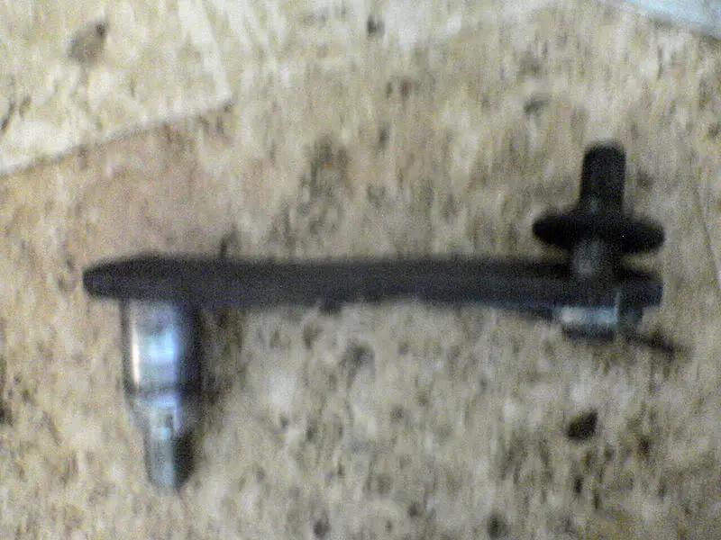

well, i decided to pull out the whole shifter, and I'm not sure about this kit...
Let me get this straight...
There is a long metal rod coming from the transmission, that connects to a plate with two screws in it, one welded in and the ohtehr has a washer on each side and a push in bolt. The welded one then connects to the shifter itself.... When you take it out of the floor console I am supposed to put one washer connecting the welded bolt and between the console, then regrease the bolt,... push it it, and put another washer at the other end? then connect the chrome shifter, a bushing, and then the nut?
Cause the bushings are too small to cover the welded bolt, I'lll post pics in an hour or so.

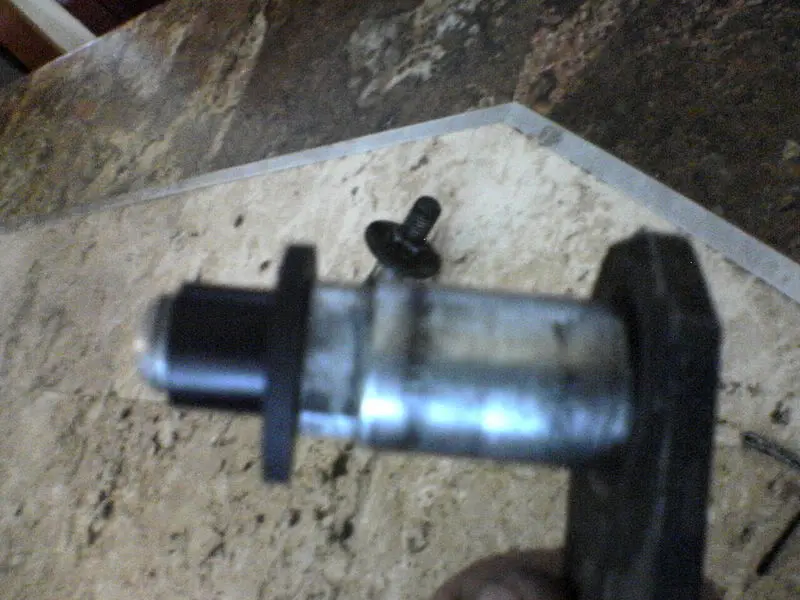

Left side connects to chrome part of shifter and goes through the floor console, right side connects to the metal rod going to the transmission.
This is a picture with a bushing
too small?

Jun 30, 2007
#11
  • Jun 30, 2007
  • #11
anyone?
