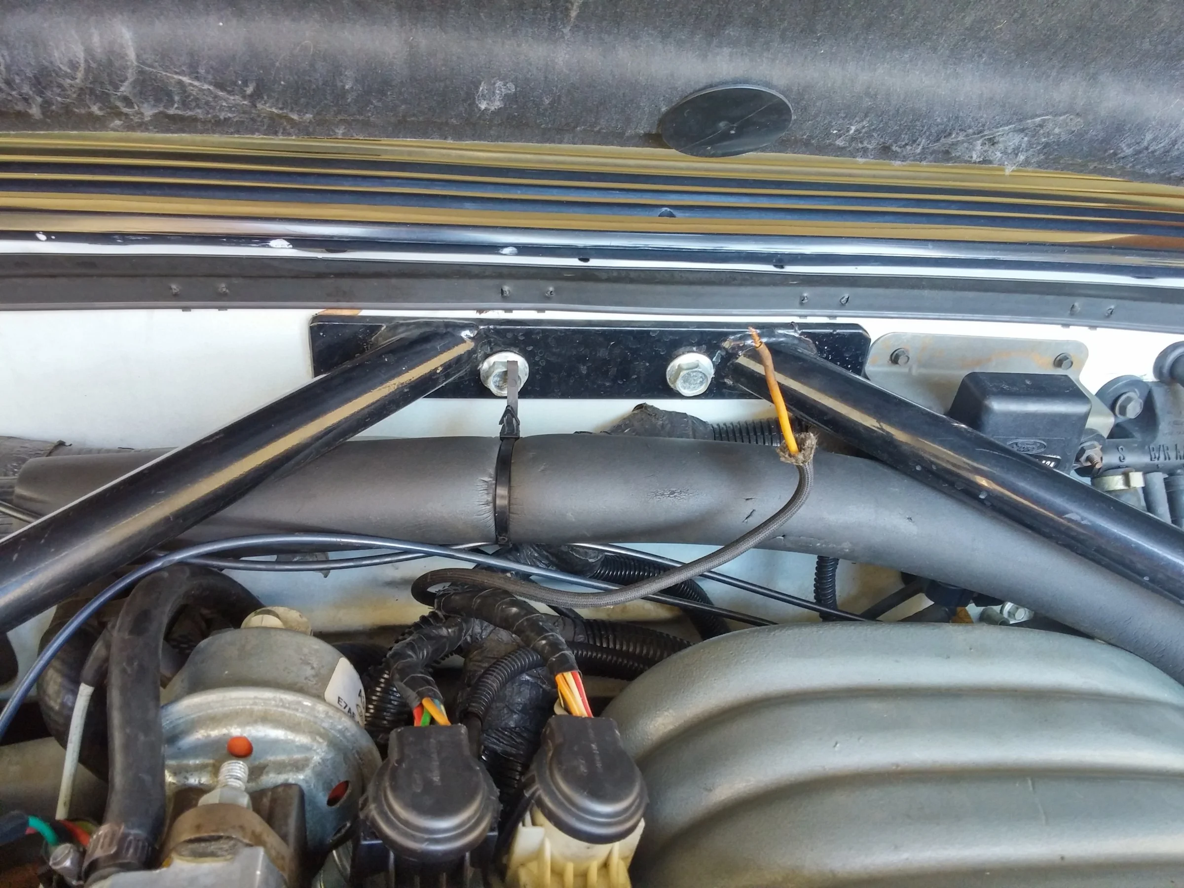

G greg2342 New Member Jun 22, 2016 2 0 1 Jul 15, 2016 #1 Jul 15, 2016 #1 Can you guys help identify this wire ? I looked through the diagrams and am lost ? Thanks
jrichker StangNet's favorite TOOL In Remembrance. Thank you for your contributions Mar 10, 2000 27,512 2,811 234 Dublin GA Jul 16, 2016 #2 Jul 16, 2016 #2 If it is an orange wire, it is the O2 sensor ground. Ground it to the same place as the engine secondary power ground that connects from the lower intake manifold to the firewall behind the engine. or to one of the lower intake mount bolts.
