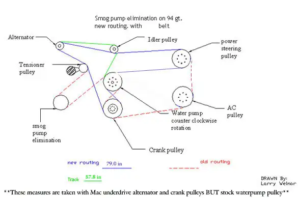

also would i notice a difference if i ran a smaller belt to just run the alt, waterpump, and crank? if so does any one know what size i would need to get?

If you can get your hand on two spare rims put those in the front they are lighter than stock rims.

You can as long as you don't use the spare tire that comes with them that's a no no. You have to get some cheap tires up front. Here at Mororso they let them it's just a rim it's the tires their concerned about.
