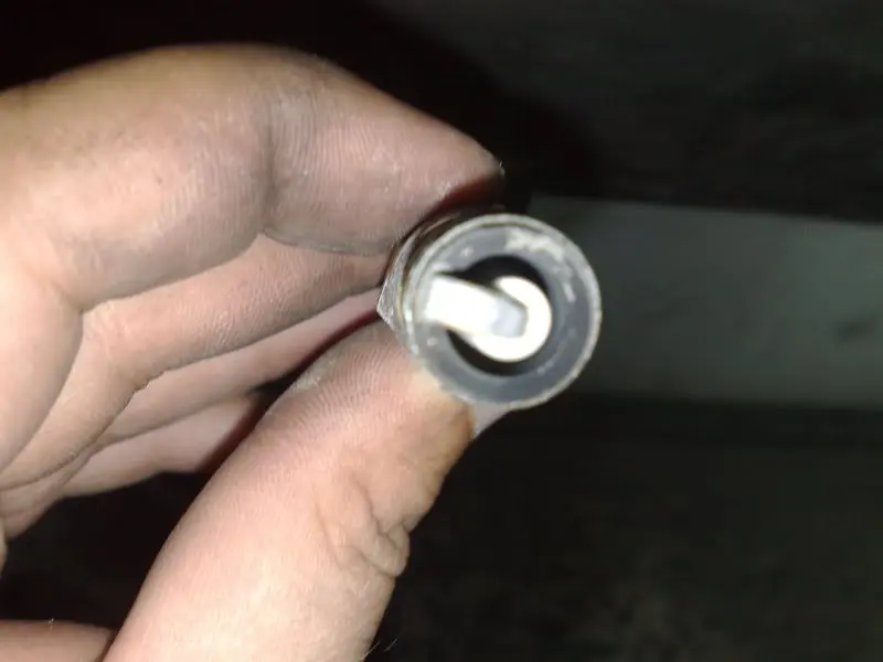

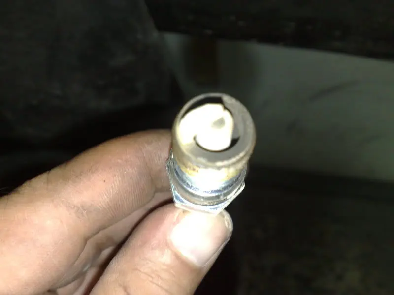

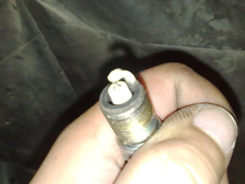

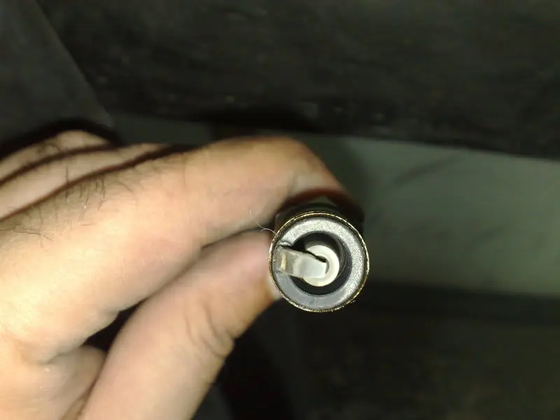

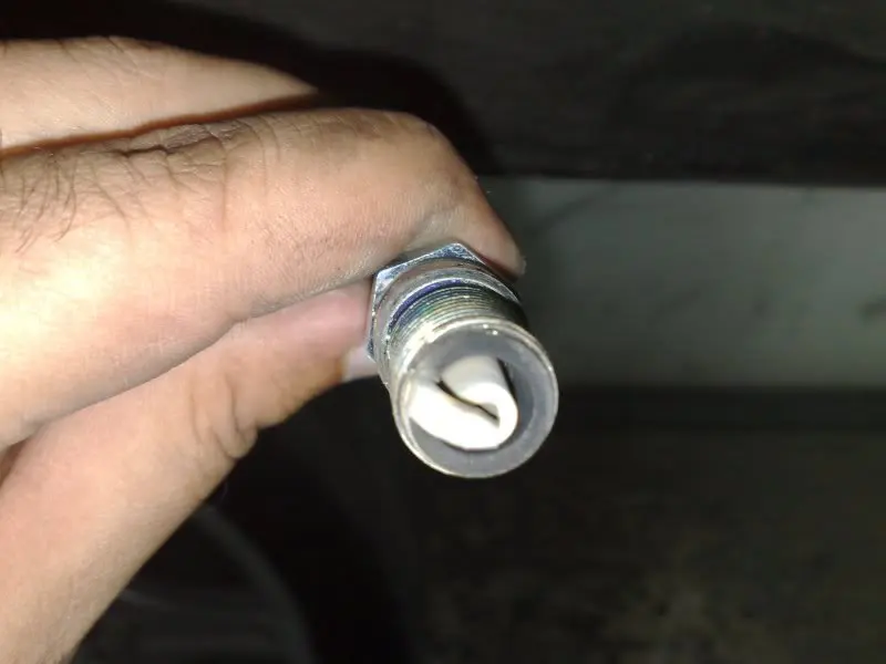

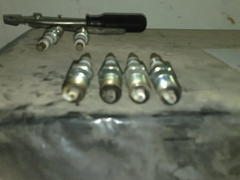

something else i have noticed is the condition of the spark plugs, see the pictures below,
the plugs are from cyl 5,6,7,8

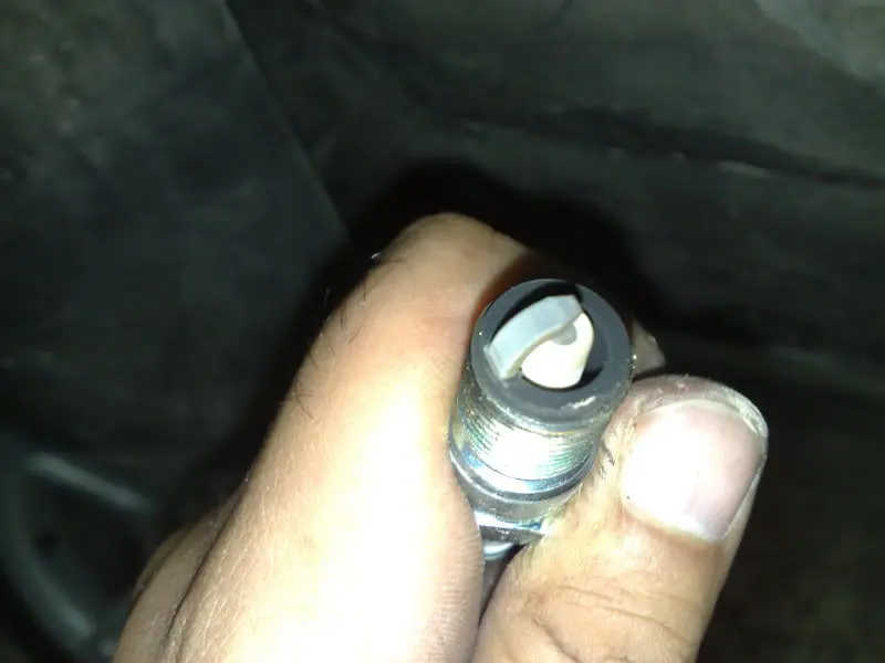

all of the plugs are showing that the car is running lean, except for cyl#6, it looks different
Plug#5
Plug#6
Plug#7
Plug#8

the guy that was helping me today said i should take out my injectors and test them at a workshop because of the difference we found in plug#6.
do you think that is related to the issue?

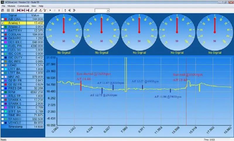

And to compare the A/F, i have connected my AEM wideband to SCT analog input and dataloged it, i think its similar see below picture
