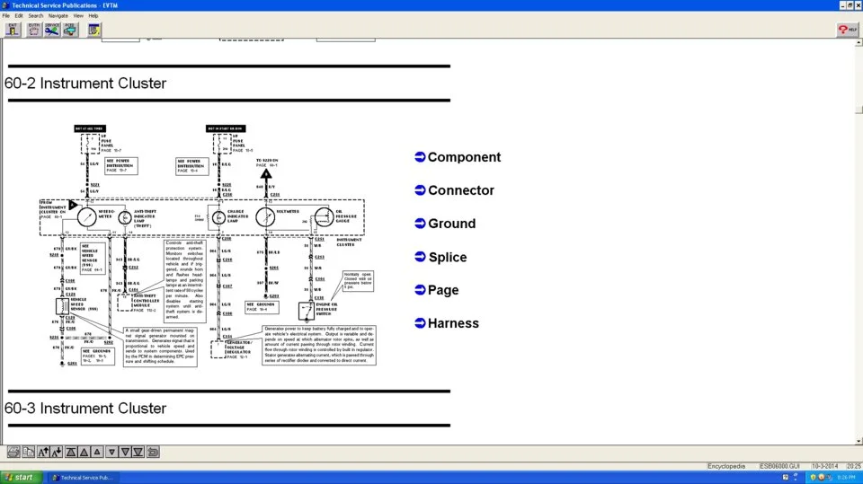

The oil pressure sender is a 6 psi switch.
