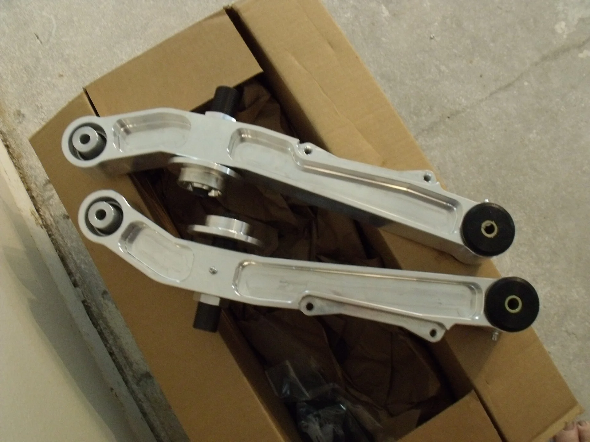

So I ordered these lower control arms from Summit... I wanted poly bushings on both ends but I just opened the box and these were in it?
I believe these are considered spherical end??
Would these be too rough riding for my grocery getter? Recommendations on sending them back for the Poly on both ends??
thanks all
I'd run those in a heartbeat. They are probably more money then the ones you ordered.

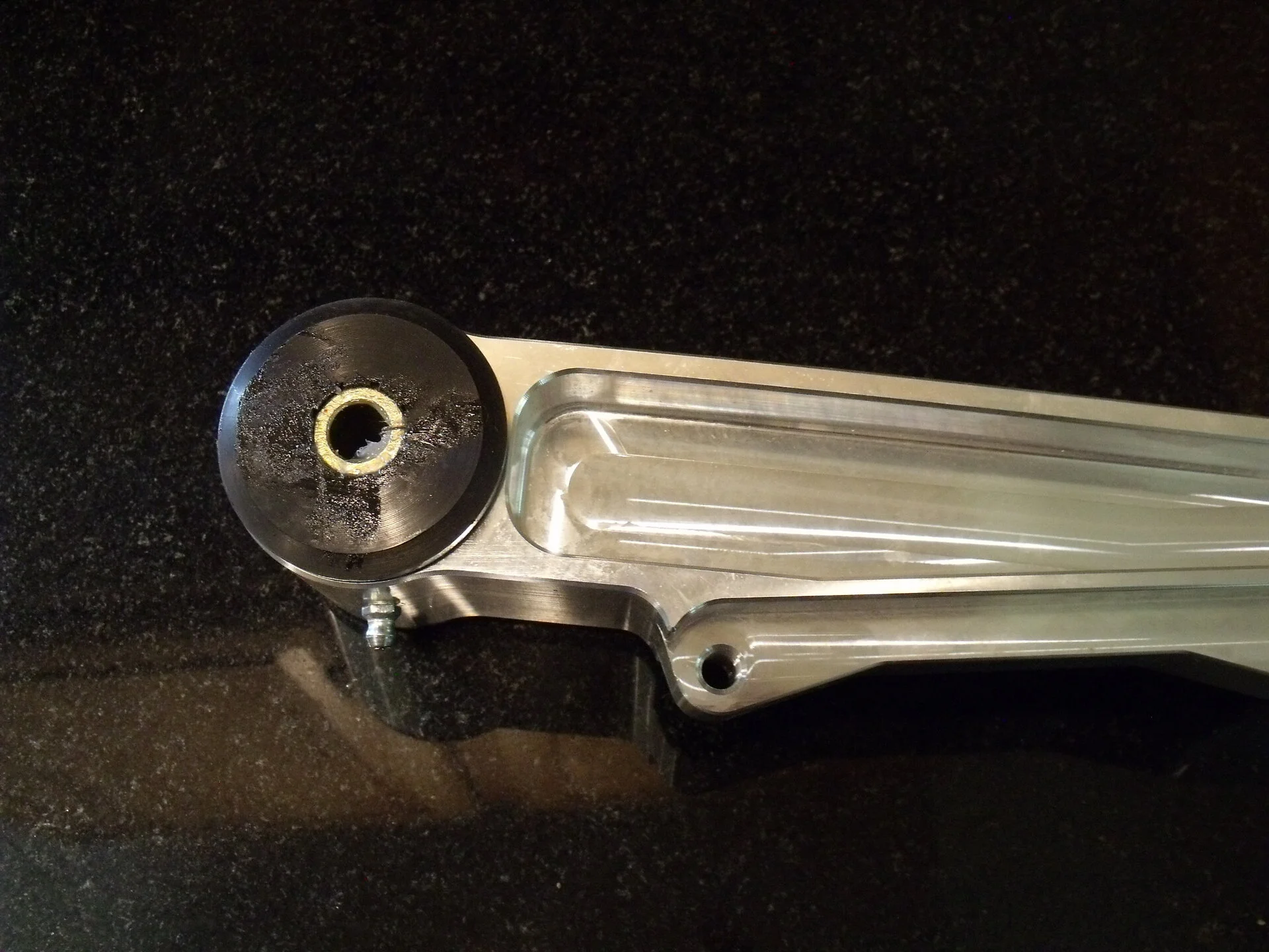

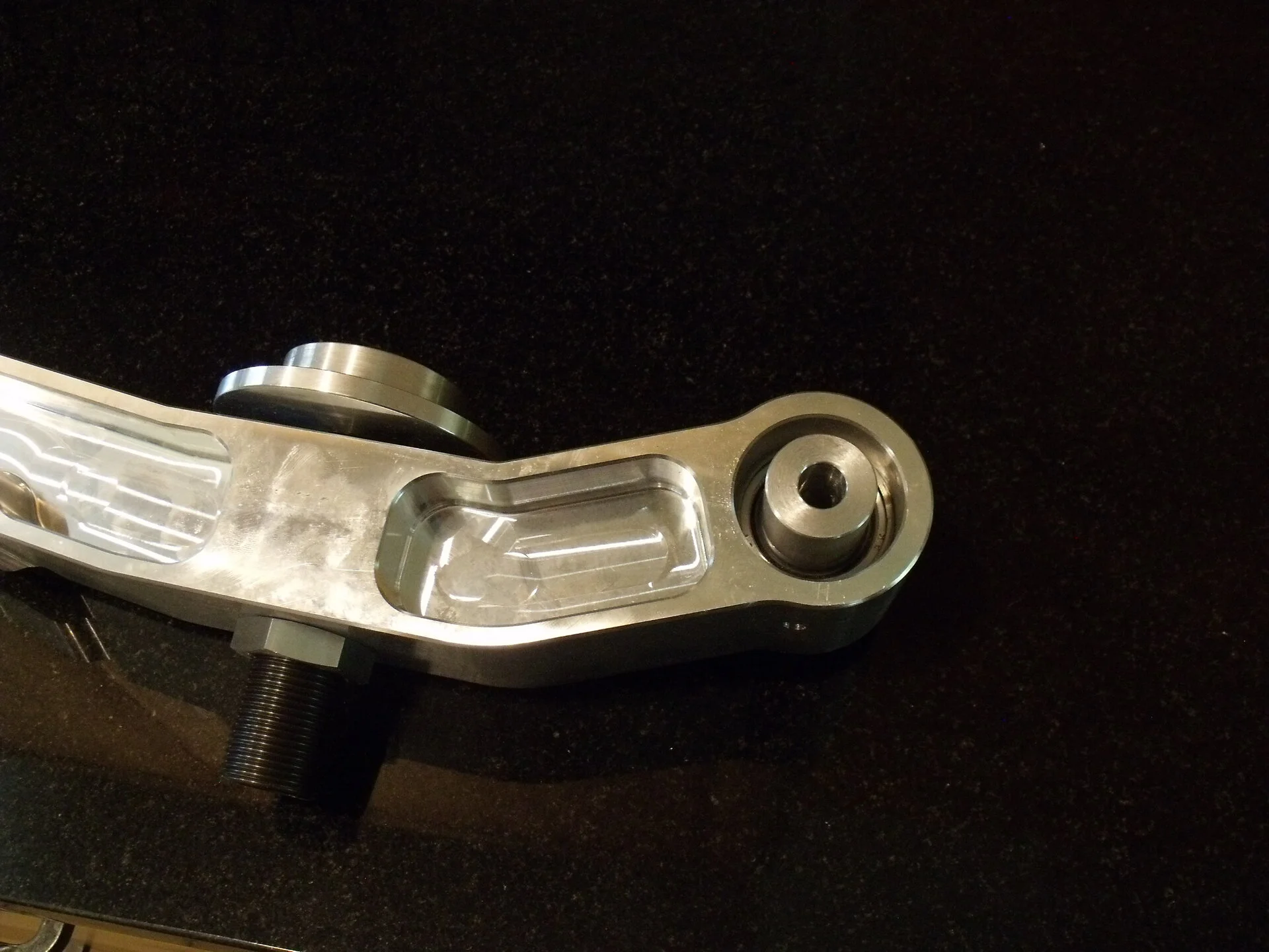

Here is another pic, my first pic might have lent to some confusion.. Looks to me like a poly end with a grease zert and and a solid spacer at the other.... The solid spacer acts like its pressed in... It will not move.....
JMO
you do not want a solid end on the housing, does the bushings fit the other end?
Summit part number?
I would agree... I might call Steeda tomorrow and see if any one in Tech can help....
EDIT.. I finally found the Steeda page I was looking for... Looks like I got the right # 555-4412, but Summit had the wrong picture with this number.. Poly on both ends would be #555-4410......... Steeda is calling the ones I received Poly/Spherical....
