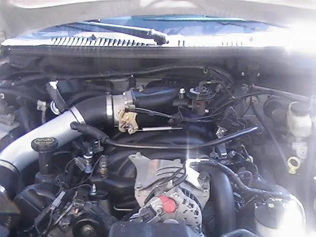

Thanks for the pics guys, those do look really nice...
Just out of curiousity, it looks like the thremostat housing faces a different direction, did you have to use a different upper radiator hose? I have a fixed chrome one that doesn look like it will fit the new angle of the housing.
Here is a pic of all the parts for the intake.. If you look you will see a new 90deg hose and a short pipe next to it... that is how you hook you the upper hose
