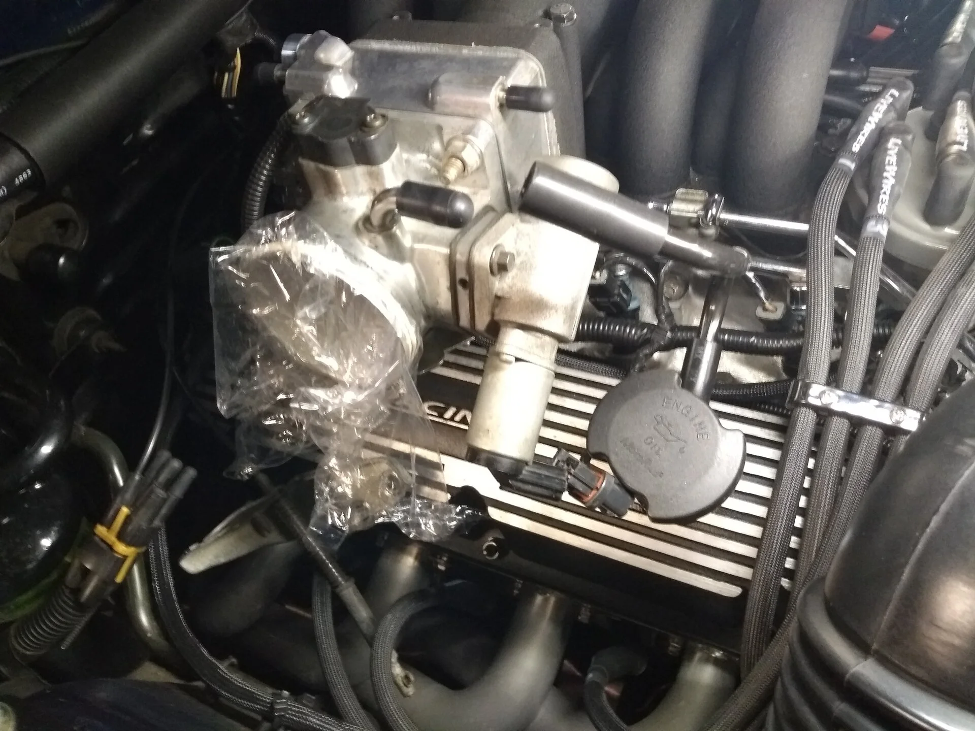

Hey guys,

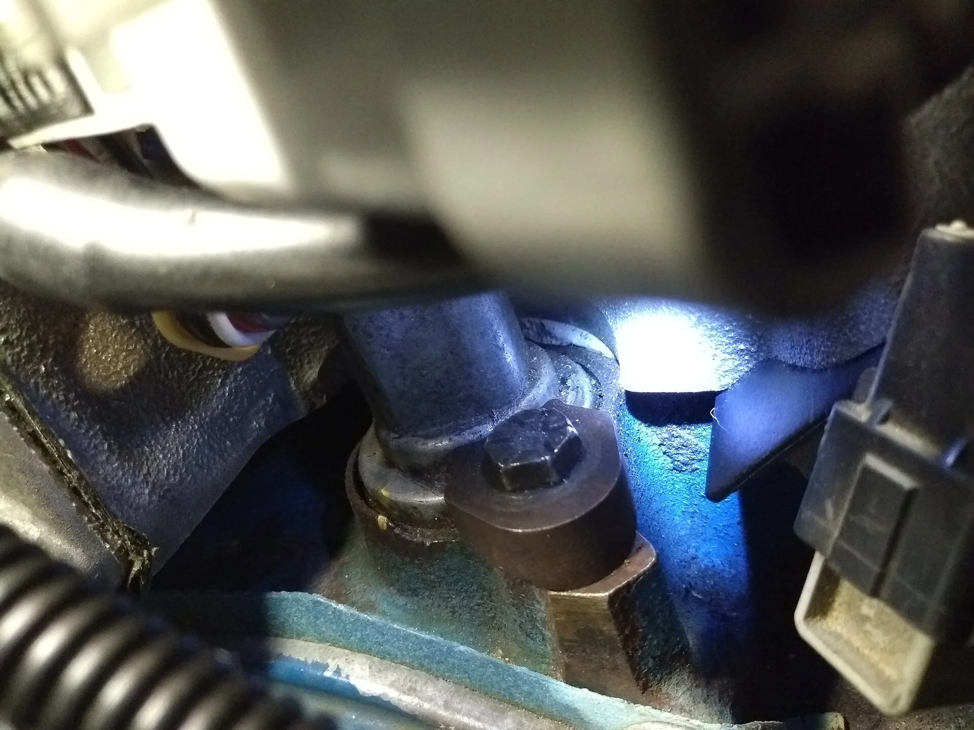

I just used my smoke machine for the first time. I hear a massive hissing sound front drivers side by lower intake. I can also feel air with my hand by it.
I've never replaced lower intake gaskets. You guys agree this is the problem? Also appears to be leaking at the TB and by the solenoids on passenger side shock tower.
Help appreciated.
Trying to post a video.
Maybe pic of the area in question pointing out where the air is heard.
Do you have smoke coming from this area?

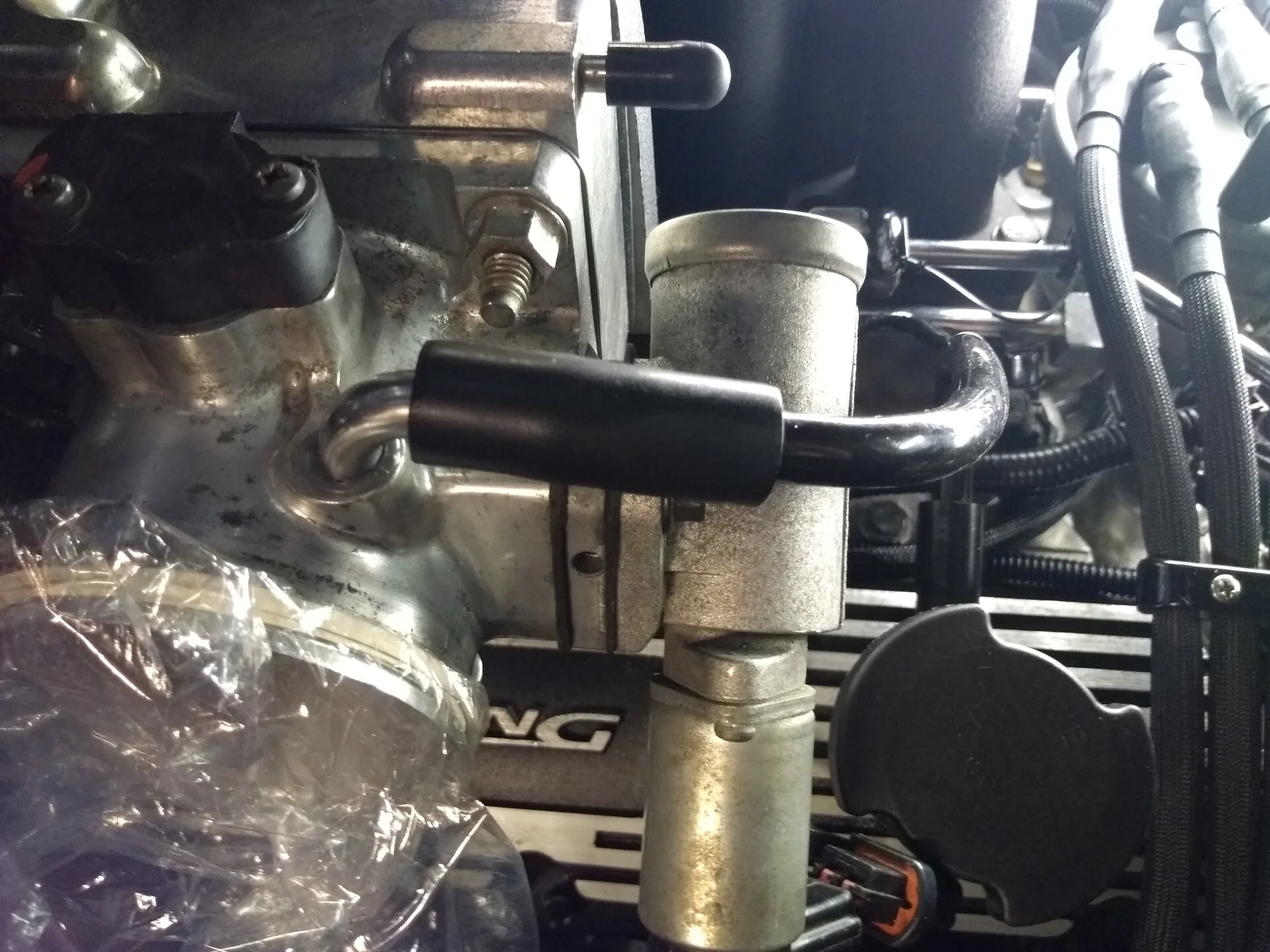

Okay here is what I've found out so far. If I disconnect the crankcase tube that's connected to the throttle body and cap it off like in the picture. It makes zero hissing sound by the lower intake/distributor area. I then just get smoke coming out the throttle body area, mainly by the spring I think.
Now, if I leave the crankcase tube connected to the throttle body, the air/hissing sound is present.

Where air sound coming from.
Is it coming from the distributor hole?Maybe a new ring would help.
A vacuum leak does matter.
I did my lower intake gasket twice and couldn't get them right so I bit the bullet and had an experienced shop do them. I used studs, rtv to both hold the gasket in place and seal the front and rear but no success. I think they used adhesive spray to ensure the gaskets did not slip and RTV in the front and rear.
I replaced the lower intake gaskets. I put some Permatex high tack around the water jacket ports to help keep the gaskets from shifting. Also used the old bolts as studs to help.
