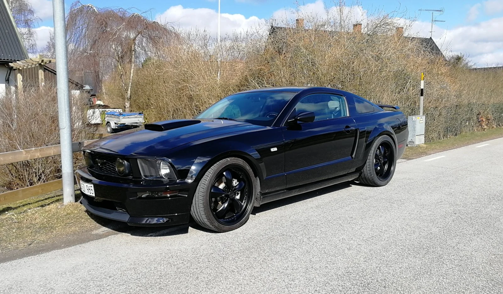

I would like to slightly lower my 2008 GT/CS. For looks and handling Has stock 18” wheels. I was thinking just Springs. I don’t want any fender rub.
Any help would be appreciated. Thanks.
I used the Eibach Pro kit on mycket GT/CS. It gives a really nice look and removes the high rear end completely. No rubbing with 20" rims. You need a set of camber bolts too. Took me 4 hours to install on my driveway.
