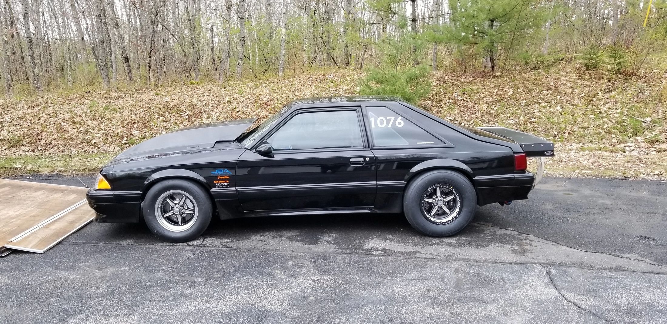

275/60/15 on 15X10 double Beadlock rim with 6.5" backspace.
Typically a 6.5 back space works well and you may need a 1/4” spacer but it all depends on the tolerances on the assembly line that day. Quad shocks typically need to be removed but it varies.
Sweet. Thanks. That wheel set up looks good. What size fronts do you have there?
It is a 15X4 wheel with the Moroso front runner tire @ 26" tall.
