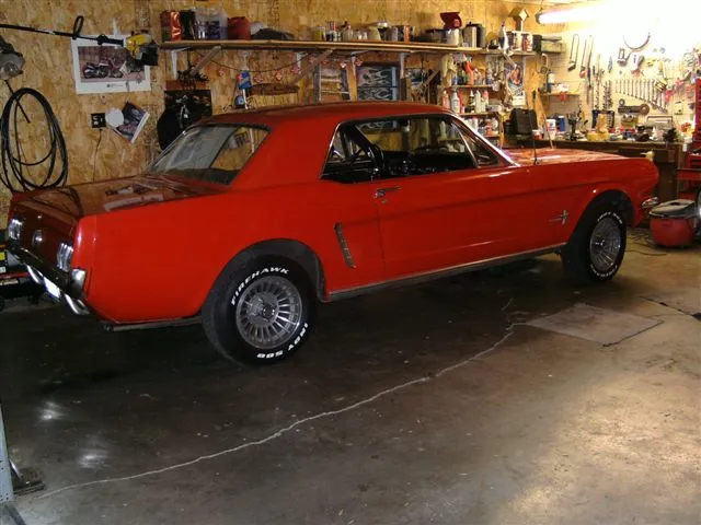

Thanks everyone for your feedback and information. here is a picture of my mustang.

That's pretty high, looks like it may have stock standard leafs in the rear and stock springs in the front. Same suggestions as earlier for the front, cut the springs or swap to 1" drop after doing the 1" shelby drop. For the rear you can try adding 1" lowering blocks between the leafs and the axle. I wouldn't go any thicker than 1" spacers, next step would be to get mideye springs to replace the standard eye. Can't see the rear shackles, if there are lifting shackles on it remove them and replace with the shorter stock ones.
