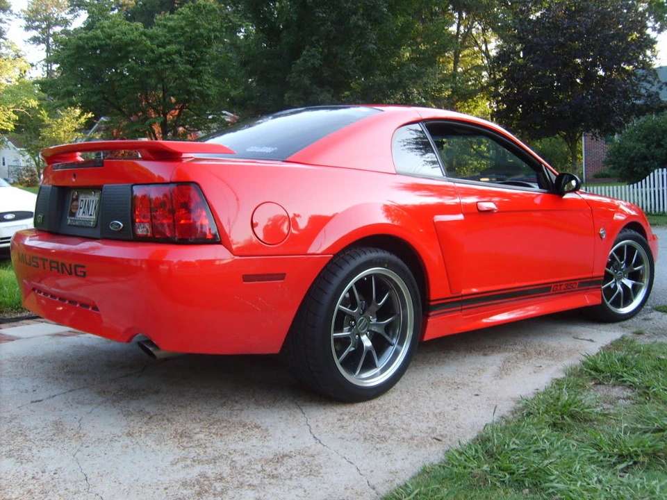

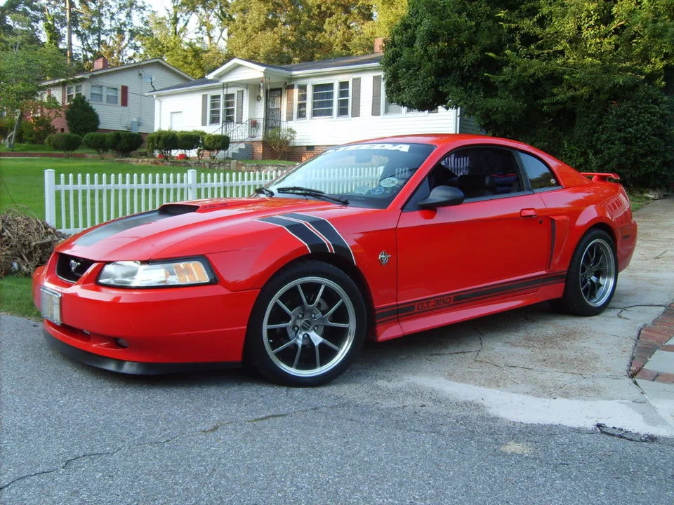

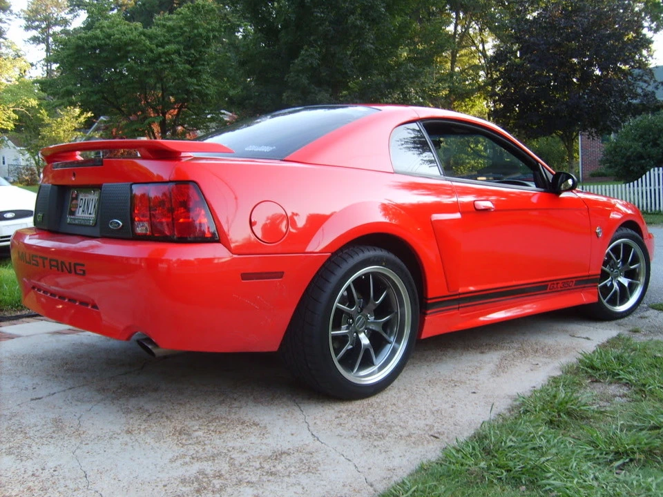

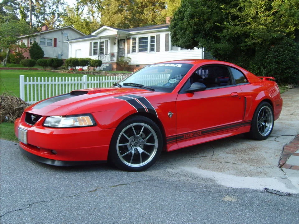

I have the Pro Kit on my car. It lowered the front right at 1.5" and the back 1". I like the stance and I didn't replace anything else suspension wise. Also, I love AM but I got mine cheaper through UPR.
These pics aren't the best since they're not straight from the side and the cars on an incline, but if you look at the wheel arches you can get an idea:
