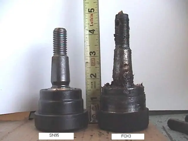

Not trying to jack the thread but what spacer are you refering to? i am fixing to be doing the swap and sounds like i overlooked something.
Its a 0.330" tall spacer, this is needed to properly fasten the crown nut on the lower control arm ball joint (the fox ball joint is about 1/2 taller than the SN95s and you will run out of threads
If you are buying new tubular A arms, get them with the SN95 ball joints. Here are pics of a homemade one.

I didn't feel comfortable using the spacer so i went ahead and updated my balljoints to sn95 joints.

Using the spacer is not a problem. I used two hardened washers on each side to raise my crown nut upward. Just place the spindle on the FOX joint and then place the two washers on top of the spindle, then tighten the nut down. I have had 4,500 trouble free miles and counting!!!! I bought these at Lowe's Home Improvement for like 2 or 3 dollars.
