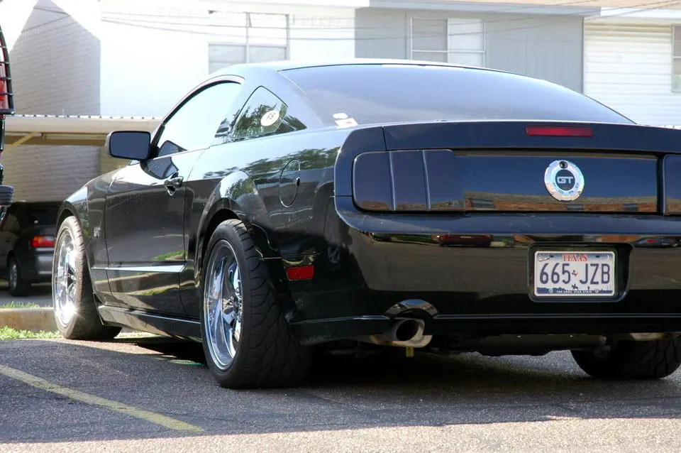

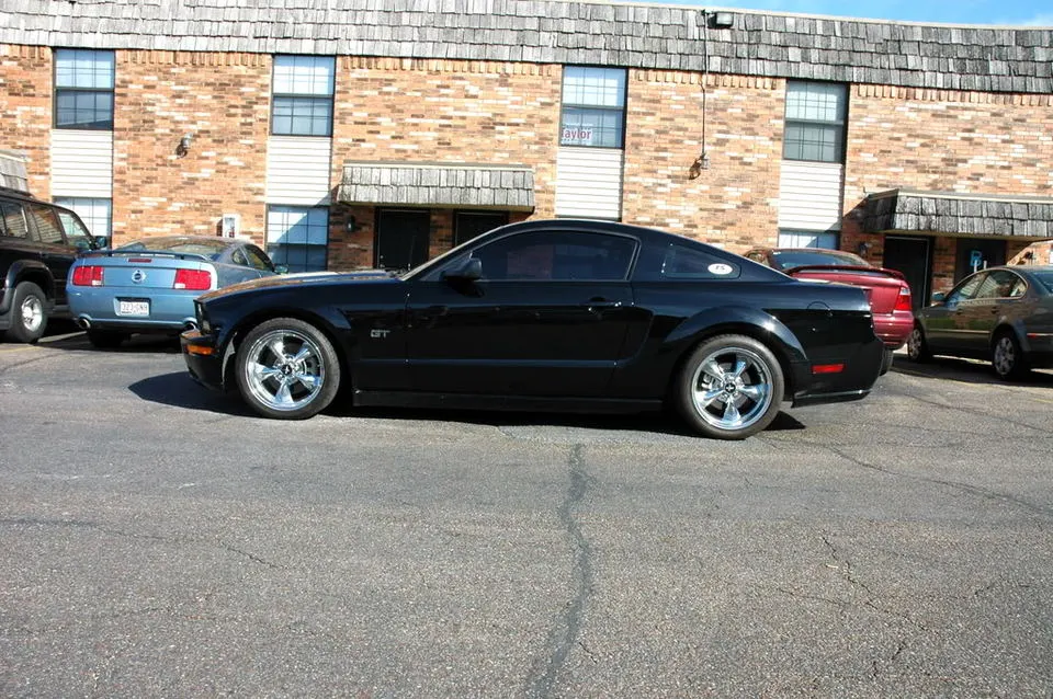

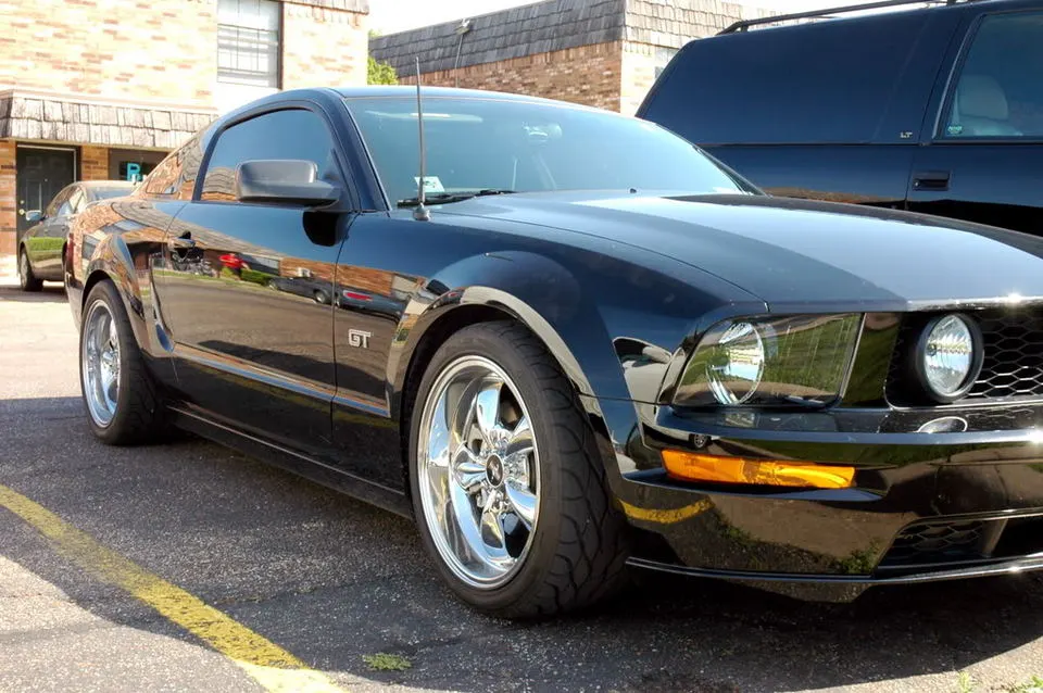

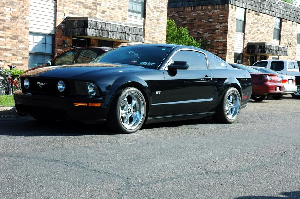

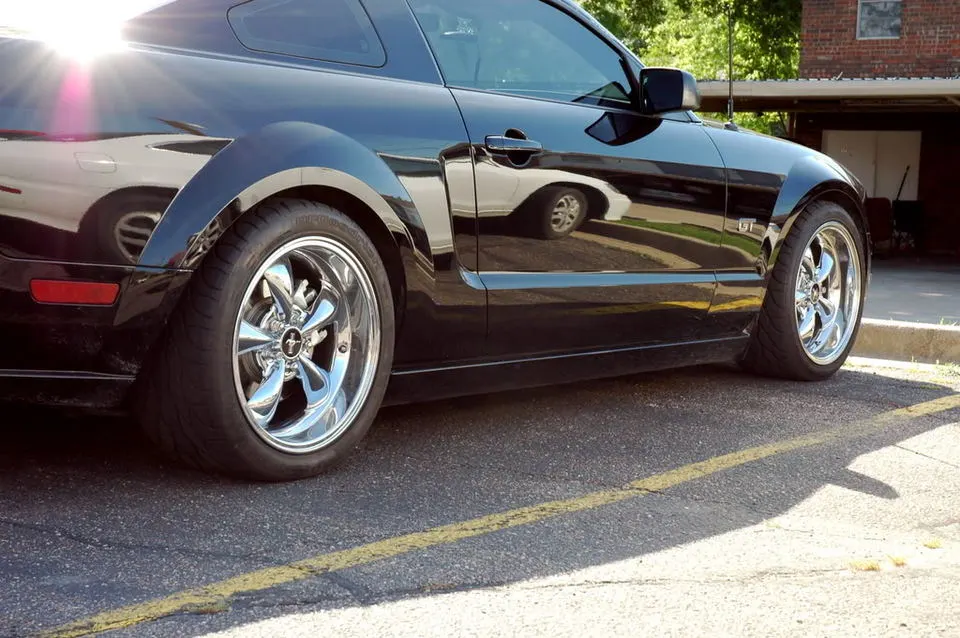

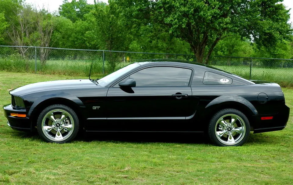

I hope he doesn't mind, but BUstang recently lowered his car with the Eibach Sportlines.
pics:
Before:
After:
He did all of it in a parking lot at his friend's apartment complex. Got the spring compressor from autozone and went at it in an afternoon. They didn't use an air gun or anything...it is possible haha.
Tire/Wheel sizes (from what I can remember)
front: 18x9 with 265/35/18's
rear: 18x10.5 with 295/35/18's

Man that looks real good. That was the look I was trying to achieve, just the right amount of wheel well gap. Mines black also. I guess I should try to take some picks and post them. I think your friends looks better than mine though.
