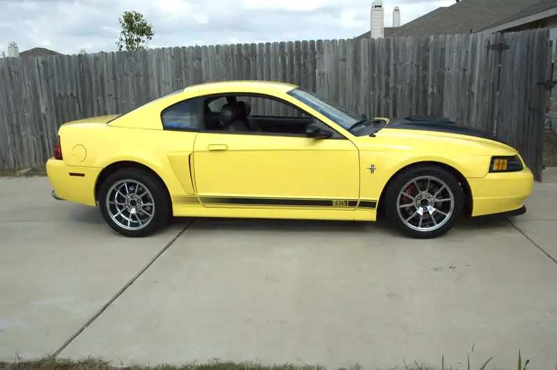

I have sportlines on the mach and they aren't kidding when they say you have to watch what you drive over. If you want just a little drop try and run down a set of take off Mach 1 springs, i think they are about .5 inch lower than a GT.
Here's the mach with sportlines in the front and stock rear springs.
