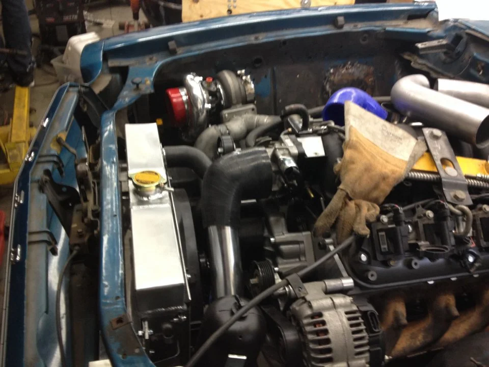

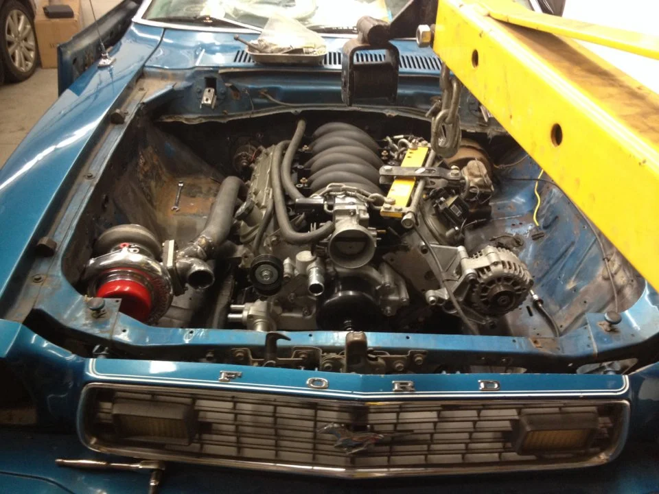

Found a home for the turbo
I did the same with mine, though I angled it into the corner so a filter would fit nicely and also get a little bit of cold air into it from where the battery cooling duct used to live. I ran the turbo outlet through the inner fender, gives a perfect route to the intercooler, looks like you're planning to do the same?
You've got some subframe connectors going in too right? That's going to be a crazy fast car.
Ya same idea for intercooler routing, ya I have subframe connectors in it just picked up the fuel system today

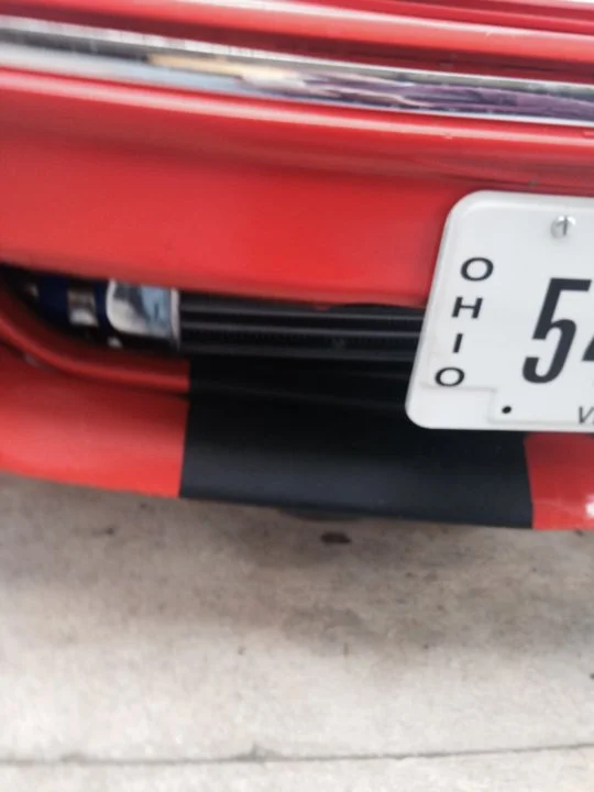

Cold side pipe looks a little close to the belts, I brought mine in through the driver's inner fender instead. A compact IC sits perfectly in a II (even with an AC condenser), seems like it was made for it.
