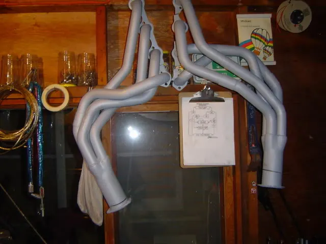

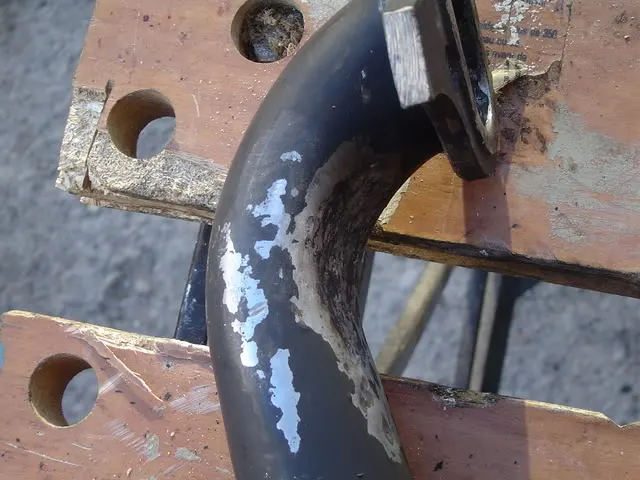

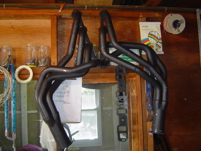

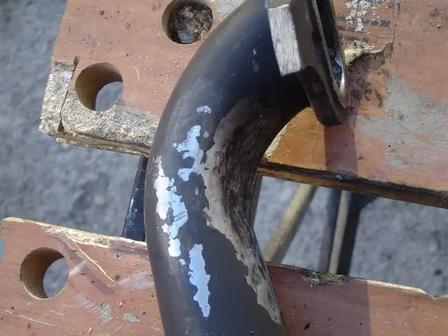

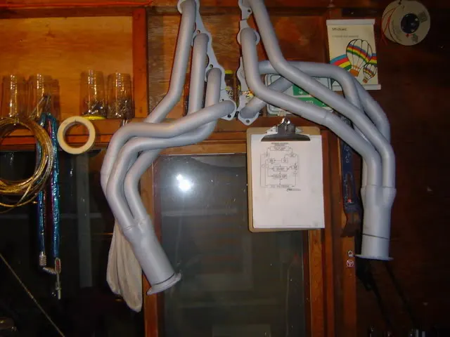

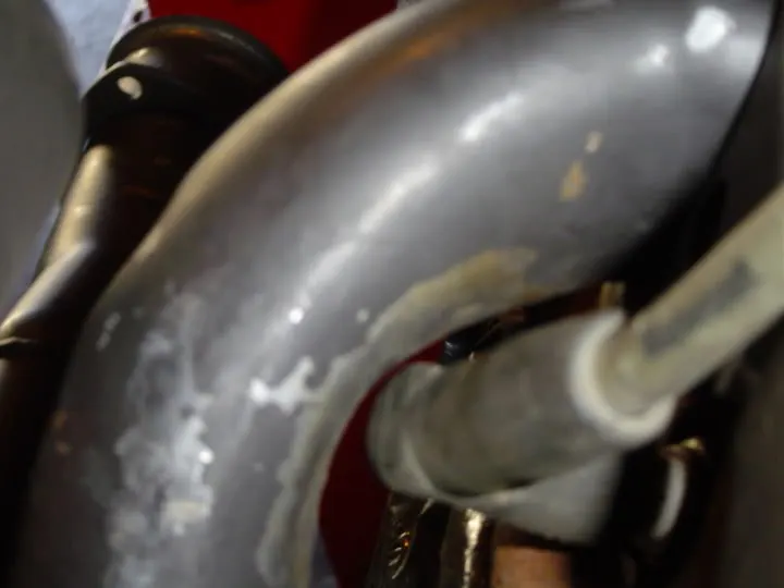

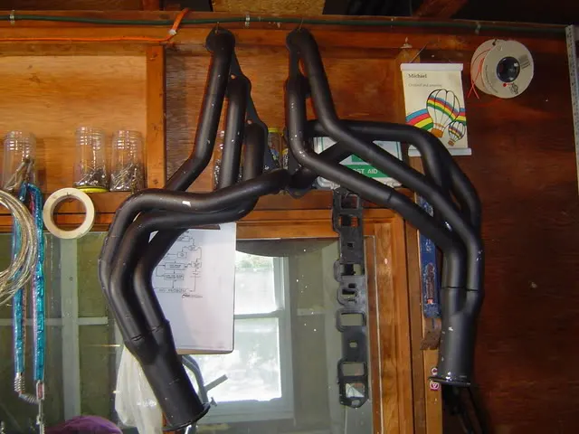

Yep, and I had to do some work with a BFH to get them to clear on the #4 plug. You will need 90* wires and a heat bootie on that plug too. I would reccomend tossing the header bolts that come with it and use a set with 3/8, 5/16, or allen heads. I also painted mine with VHT 1200* silver header paint.
Here's some pics: (56K Die!)
