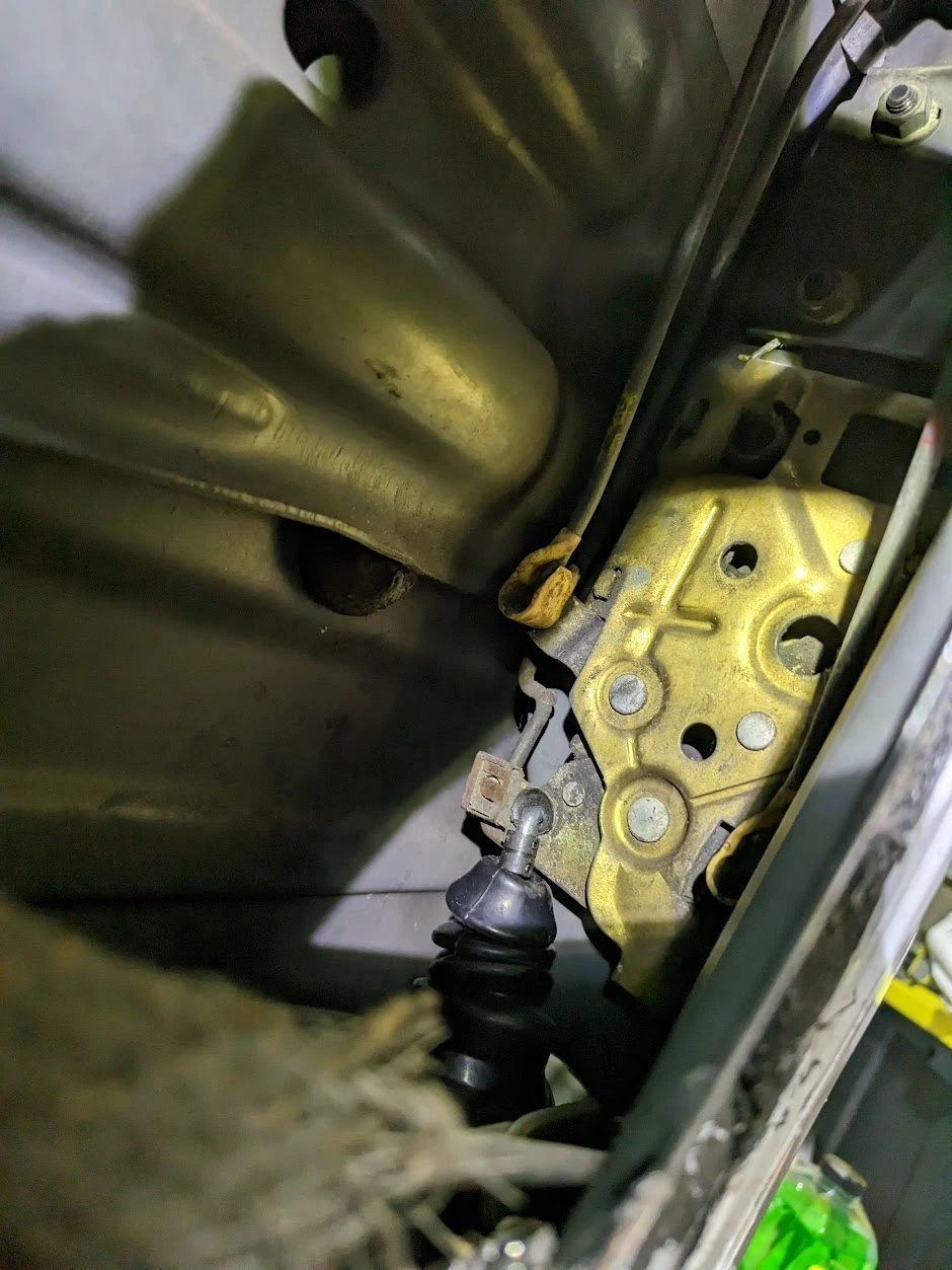

Hopefully a straightforward one. I swapped the door lock actuator and I have lock/unlock (mostly) functionality on the passenger side now (prior, there was no movement -- motor was dead and the actuator I pulled out was beyond shot), but the lock mechanism itself (at the joint) feels fairly stiff even without the actuator connected. It moves with a fair bit of force either at the key or moving the door lock up/down.
I'm hoping a little bit of lube or grease will get this sorted out, but I'm curious if there's a general go to for the lock mechanism (picture of the area I believe is experiencing friction)?

I had that problem,so I removed the door latch and soaked it in carb cleaner( berryman gallon can) then lubed it up.
A lot better now.
Good parts cleaner will help get the gunk out. Soaking down with WD40 has shown good results. I use white lithium grease in a spray can for metal latches like ours. Shake the can well.
Spray the latch mechanism with WD40 on the inside of the door (since you can get to it now) to wash out the grit then spray lube on it, white lithium is excellent for this, also spray the latch on the wheel with the teeth on the out side of the door. Insert the little red tube on the WD40 nozzle and spray the door lock from the outside and insert the key and turn it several times and spray it again.
Thanks all for the tips, the actuator is brand new (from LMR) and I slapped a rivet on it and all with a ton of tightness still (even when the actuator isn't linked in). I think I'll try the recommendations from a few on cleaning the mechanism and lubing it up.

EDIT: I had been looking for the mechanism, but I actually finally found it if lubing and greasing it up doesn't work I think: https://lmr.com/item/LRS-21813A/79-93-Mustang-Lh-Door-Latch-Assembly
Water should not be an issue inside the door as long as the dew wipes are in good condition, any white lithium spray is fine
