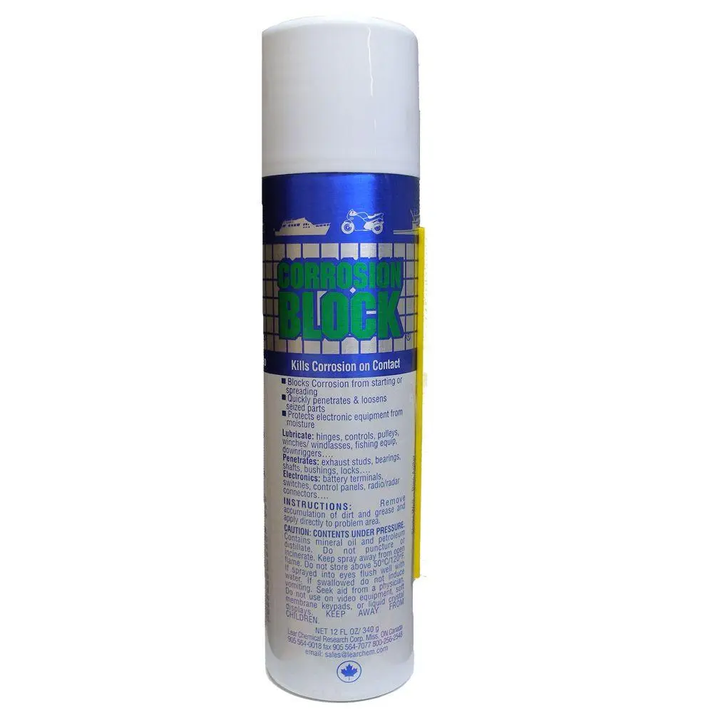

I made the switches work like new with Corrosion Block. It removed all the corrosion on the switch contacts.
Used it at work to renew 480VAC-3Ph switchgear.
It's expensive, but 1 can will last many years. I also use it to lubricate bicycle chains.
Also available in 55gal drums.
The military has been using the MilSpec version of this for many years.
