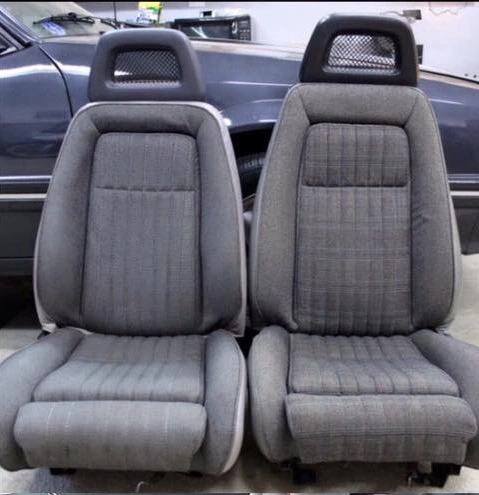

Here's a photo showing the seatback 2" difference. The frames are the same. The difference is due to the foam in the seat
Ignore the headrests as they were swapped. 90-91 on left, 87-89 on right.
