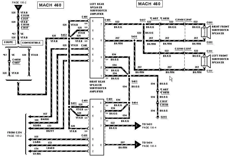

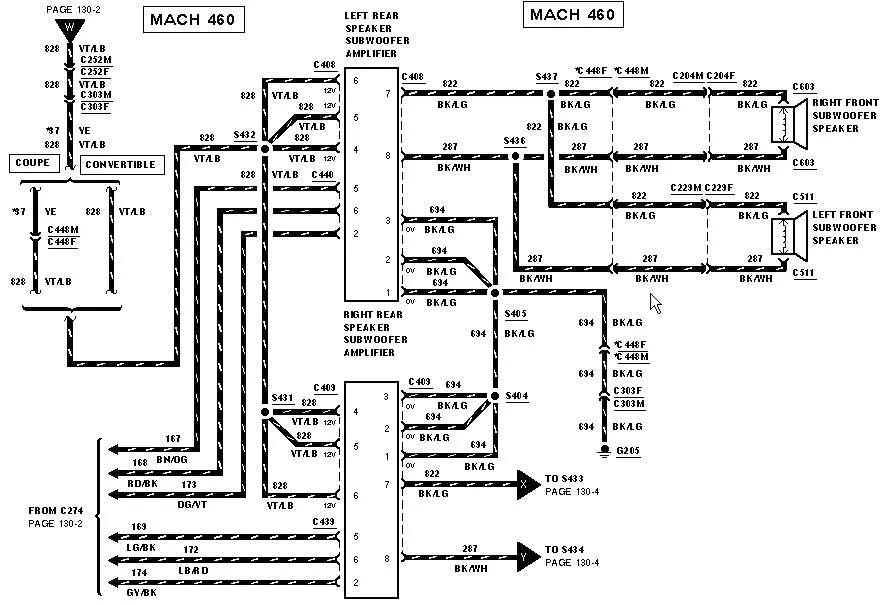

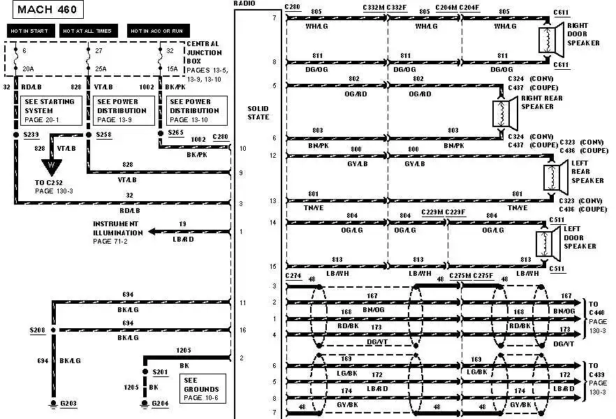

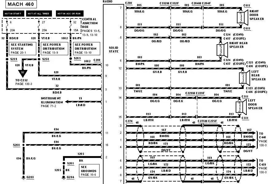

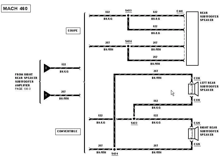

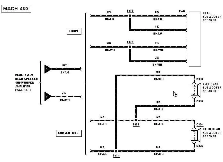

Hi. I need some info on my system that no one has been able to help out with on other sites, so I'm hoping someone here can help me out. Here are the specs: Bought used 1997 Mustang V6 with Mach 460 system
Includes 2 rear amps in rear sound bar, 1 head unit amp under
radio, 2 front window tweeters, 2 back sound bar tweeters, 2
front woofers, and 2 back sound bar woofers
All fuses all fine
All wires are connected
Minimal sound only coming from 2 front & 2 rear tweeters
No sound from 4 woofers
Changing treble, bass, fade, etc. does not help
Disconnecting rear amps did not help
According to the literature out there, the front amp supplies the tweeters and the 2 rear amps supply the woofers, but are tied together somehow.
Can somebody help? Is it both the rear amps?
Thanks for any useful info.
MACH 460 HELP
on the front amp,there are 3 connection ports.when looking at them right side up, from left to right,they are, port #1.power input/tweeter output. port#2.power output to rear amps. port#3 speaker input from stereo head unit. i never had the problem you describe,hope this info helps alittle.
