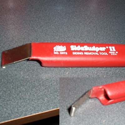

I found this tool handy.. after hours of trying to force them on i went looking for a tool. Its called "SideSwiper II" and I got it at lowes. After getting this tool got both the brake and clutch pedal on in 5 mins, clutch in about 30 seconds. Without soap or hot water or anything.
