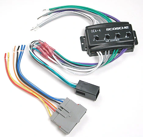

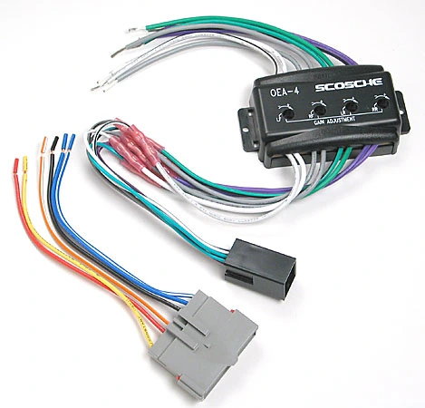

It's actually not hard to do man. The little black box with all the speaker wires: white, white/black, grey, grey/black, purple, purple/black, green, green/black, you need to cut the end off of it and strip the covering off the wire. Next get a pair of cheap RCAs and cut them at the ends and strip the ends of those wires too. Simply attach the two wires from each RCA strand(8 total) to a different speaker color(8 total): The red end of the RCA to the left front + and -, and the white end to the right front + and -, and so on. Then just plug the RCAs into the pre-amp outputs on the back of the radio and you are all set. The reason for this is because you want the head unit to send a low level signal to your stock amps, if you don't it will read a high level and that is bad. If you have any other questions and need more specifics let me know.
This is what I bought for my Alpine HU. (From Crutchfield) It will work on your Pioneer too. The instructions were great and you really need something to lower your outputs so you don't overdrive your amps. Mine works perfectly. No other components needed.

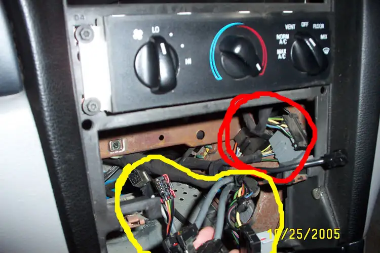

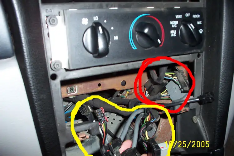

Alright heres another thing i just realized, will these harnesses be dealing with the stuff circled in RED or the stuff circled in YELLOW? or a combination? Because after looking closer today at wiring diagrams and retracing wire colors etc. im under the impression that the deal with the stuff circled in RED...am i wrong?
I also realize that the ones that allow the stock amps to be integrated will use the tabs circled in yellow, but it seems like the speaker wires go to the black and grey tabs circled in red.

Ive already talked to metra and he told me the 70-5510 which isnt even on their website anymore. Either way.....entertain me if possible please and tell me which would go where?
Harness that bypasses stock amps would plug into what regions?
Harness that utilizes stock amps would plug into what regions?
