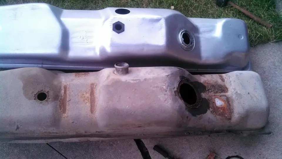

Ive always been leary of JC Whitney, but Ive officially made my first and last purchase from them. I bought a stock replacement gas tank, and sure as s hit it isnt right. After calling, they have two different options, but the only differences are fuel capacity, neither comes with a filler neck or bigger hole for the stock sending unit. It wont be that hard to modify the new one to fit, but its annoying that "stock replacement" isnt all that stock. Ive got the fuel out of the stock tank, but how much time should I let it sit (or can I put some baking soda or other powder in to kill the fumes and residue) before I remove the needed parts and weld them to the new tank?
DO NOT WELD ON THE OLD TANK. Radiator shops clean them out and then fill them with water. That way there is no oxygen and fumes inside to blow up. And they still are a little Crazy. Why you want to make old parts not smell like gas I do not know. please explain.

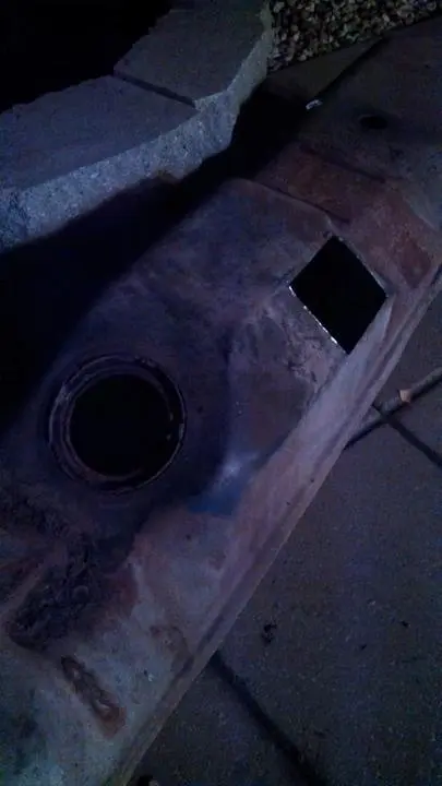

So I got the tank situation all figured out tonight. I bought the stock sending unit that actually fits the smaller hole of the new tank (thanks Summit Racing for having the correct "stock" sending unit and getting it to me in one day with standard shipping). The other "stock" sending unit is going in the trash because I already ditched the box and receipt when I opened it the other day, and who knows what it belongs to. I washed the old tank out with dish soap and water, and allowed it to dry before deciding to make life interesting using a three foot long fuse of toilet paper to see what would happen in my back yard. Holy hell was it just like a jet engine when it lit after being all washed out! I have a video of me lighting it again later, and each time I go out it will reignite with a little less oomph. Dont mess around with old gas tanks, the residue will continue to reignite, and reignite over and over! I managed to get the filler neck chopped off without any burns, and decided to use fuel tank repair putty and sheet metal screws to attach it rather than welding. My lack of welding experience led me to believe I would pry end up with pinholes and be worse off than what I chose to do. Here are some pics of the old gal all done up.
Out with the old:

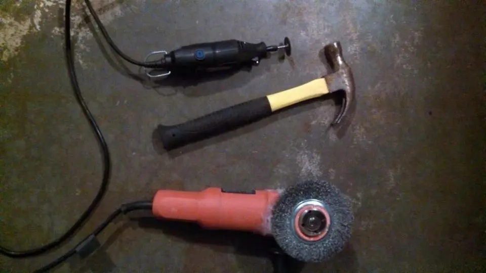

With the use of these friends I got it cut out, all the rust removed, and shaped to fit snug on the new tank:
And the end result. For those of you doubting this, the filler neck extends around two to three inches into the tank, and that putty is completely underneath all that excess metal up to the neck, not just around the edges. That thing isnt going anywhere.
