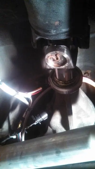

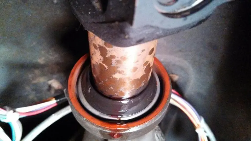

And the fun continues. Apparently the yoke originally being used for the C6 was a 31 spine with a 1.4" outer diameter. The seal on the 4R70W is 1.6" inside diameter, and the 4R70W uses a 28 spline output shaft. When I had my drive shaft shortened and yoke changed to the 28 spline, the guy found a yoke with the same 1.4" outside diameter as the original, which is why my seal wont seal now. Is there a seal to accommodate that 1.4" yoke??? Nope, sure isnt. Best part is I figure all this out too late in the day to go to the shop to get a different yoke. One of these days I will finish this swap. And since I havent posted a pic in forever, here is what I am up against:
I found the correct yoke online showing a 1.59" diameter, but I am going to hold out that the power train shop I used will let me swap their first yoke for the correct one. This shop is HUGE and really well known in the area, so I dont think they will f uck me like the little tranny shop I used. I have the part number to take to them for the correct yoke, so at least I know I am asking for the right part and eliminating the chance of someone else screwing it up for me. Here is hoping I button this thing up Monday night. :doh:

I did a test drive on my heavy duty jack stands last night with the floor jack supporting the rear axle up at ride height. She runs smooth, shifts smooth, and no more rear seal leak. I need to put some loom over some wiring, and then get her down off the stands and go for a real test drive. That will be this weekend though, cause my wife works late the rest of the week and my boys arent old enough to be in the cold garage yet. Then once our warm weather hits (tentatively April 7th according to weather.com) suspension and fender modifications will begin. I promise to actually take pics of that work though, as it will be fun stuff instead of cold hard misery.

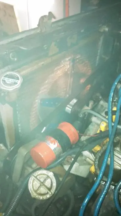

Lately I have been hijacking the Gila Monster thread too much with my truck crap (to remind Mike how he being a bad influence has hindered my life). Well in that thread a spoke of my flex fan meeting my radiator during my maiden voyage with my new trans. Here is the carnage, excuse the steamy pic:

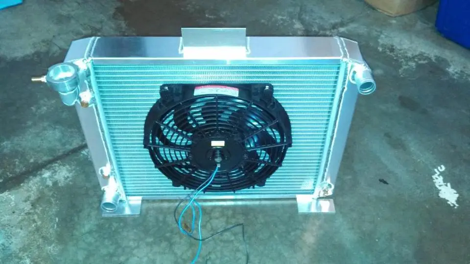

New radiator and fan going into the truck tomorrow:
If the 12"inch fan isnt enough to keep her cool, I will put a pusher on the front. Being that it is a very mild 351, I think I will be ok with a 3 core aluminum radiator and the 12" fan. Then again, the truck always seems to want more of something!

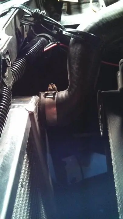

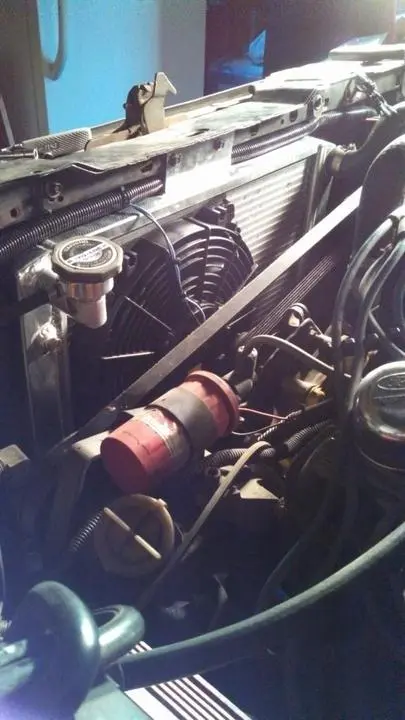

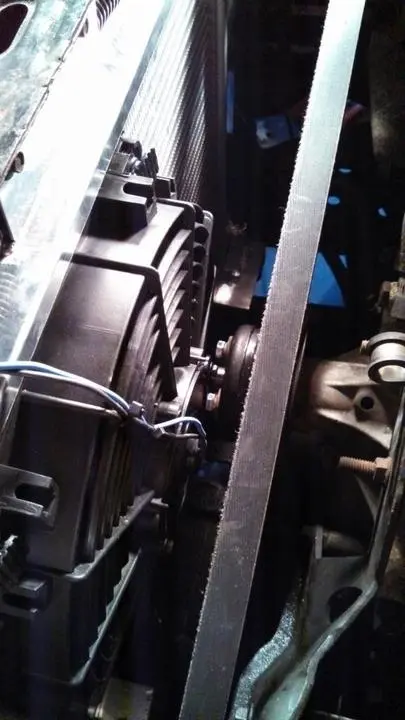

The saga continues. I had to remove the fan and mount it off to the left side due to clearance with water pump pulley. The old radiator was a 3 core, but this had a slightly different mounting point so it gave me less to work with.
With this less clearance came my zip tie chain to keep the upper hose off the alternator pulley until I relocate the alternator with a tweak to the bracket (one project at a time).

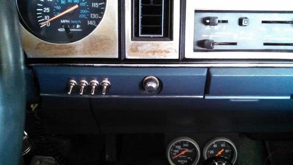

And lastly I decided what is a hot rod without a panel of toggle switches to operate your fuel pump, rad fan, trans controller, and o/d over ride. So here we go.
Well, it runs, but not good. Cooling wise, it is great. That fan pulls more than enough air, and nothing seems to be touching on the test drive. On to the bad news, I plugged the controller into my laptop and installed the software for tweaking. All I changed was my tire diameter and rear axle gearing so that it would have the correct speed calculation, and now the thing says error and wont allow shifting out of first. I tried to go back and wipe it out, but to no avail. Now I get to call Kevin at Baumann tomorrow and see if he has any ideas. I read and followed the directions word for word, so I may just ship it to him to have him do the tune, and then plug it in and leave it alone to keep from f*cking it up any more. I am basically ready to just be done working on this truck for a while!
