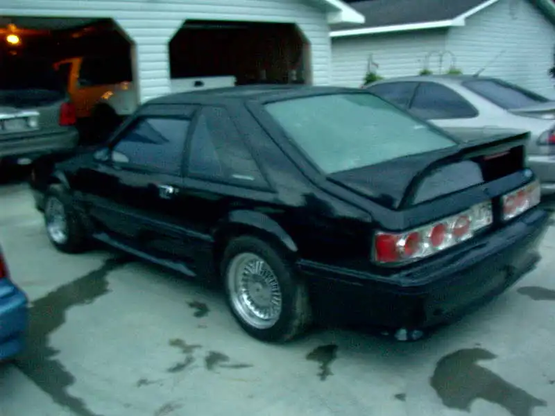

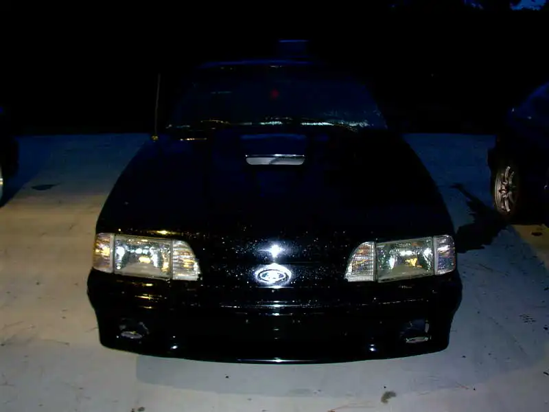

Thanks , i thought i might post some pictures of my car when i first got it and later on tonite i will post what it looks like to date.:SNSign:
oh my lord what happened to your car!!!!!!!!!

Thats how it was when i bought it , i got more pictures on the way , this is after i put my wheels on it and yes i got rid of that ugly wing

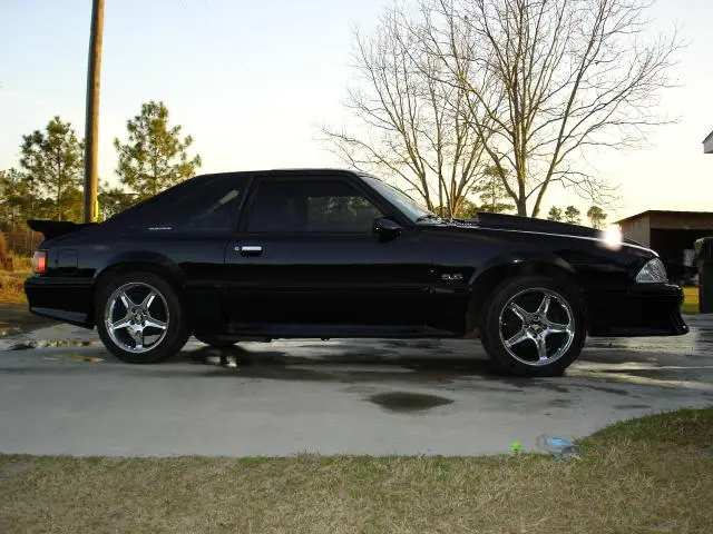

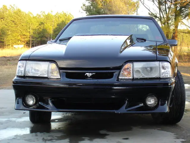

Ok i can finally redeem my self . enjoy
