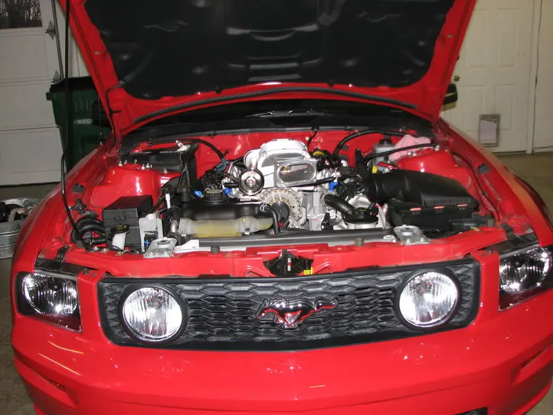

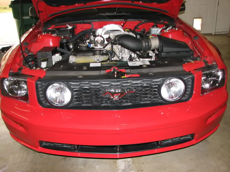

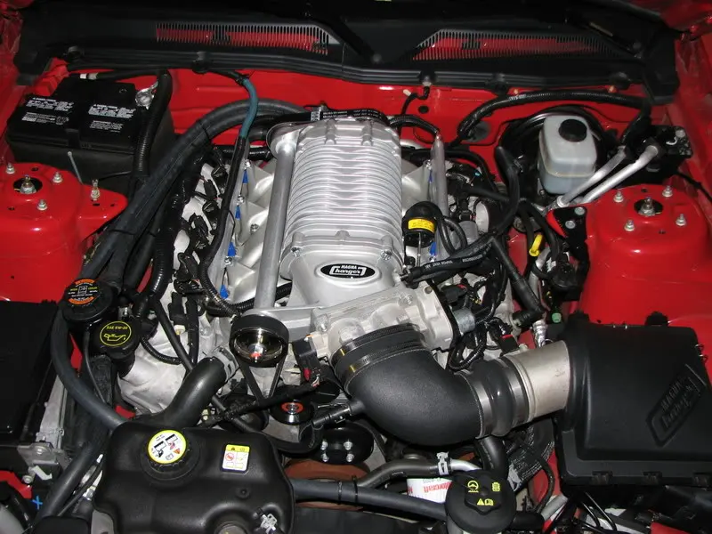

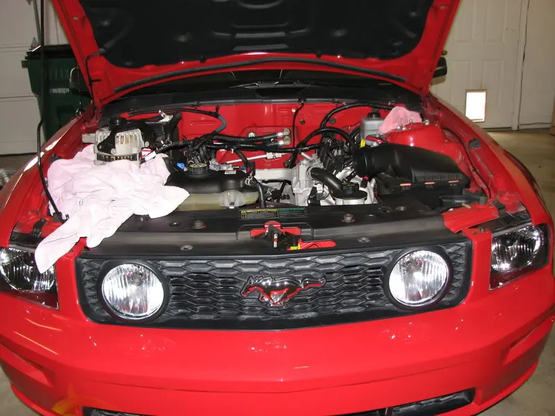

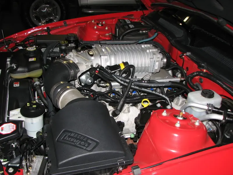

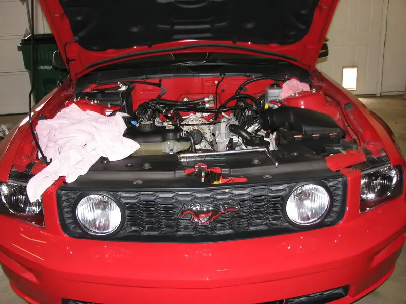

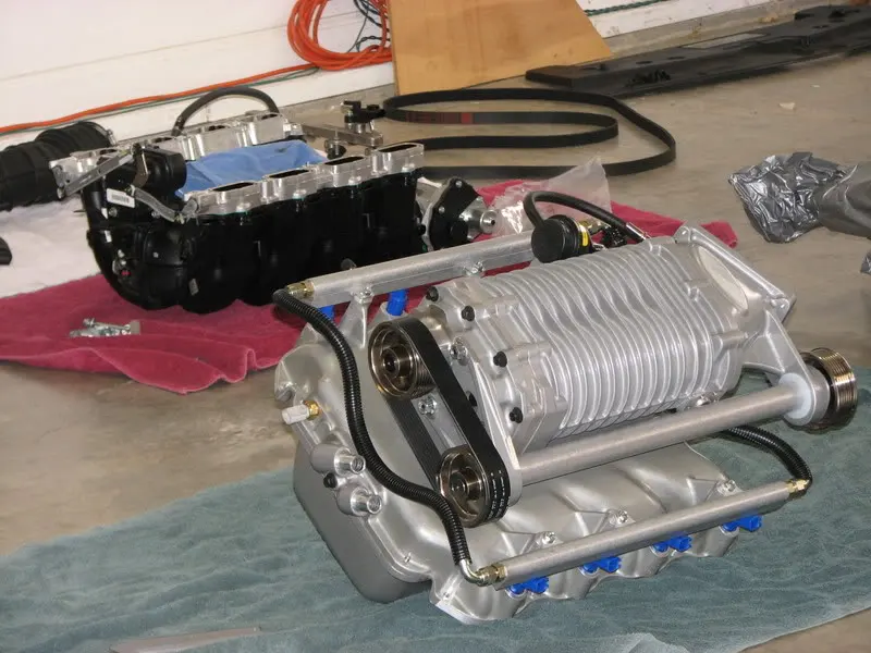

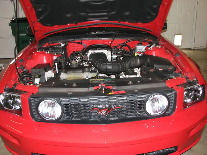

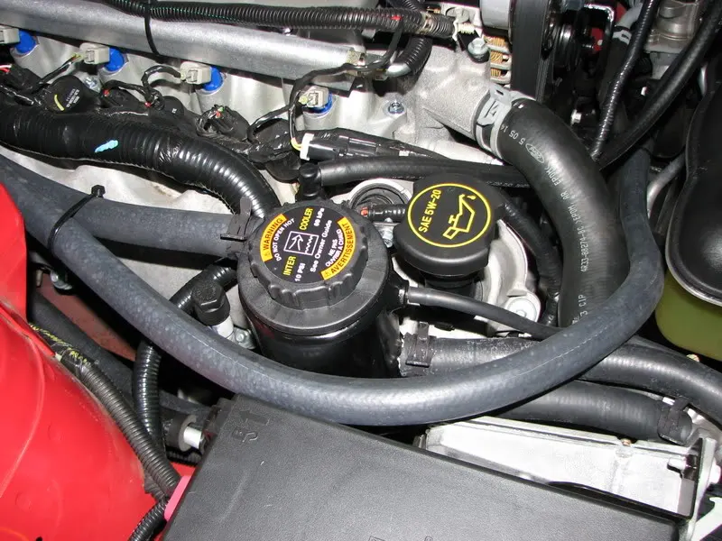

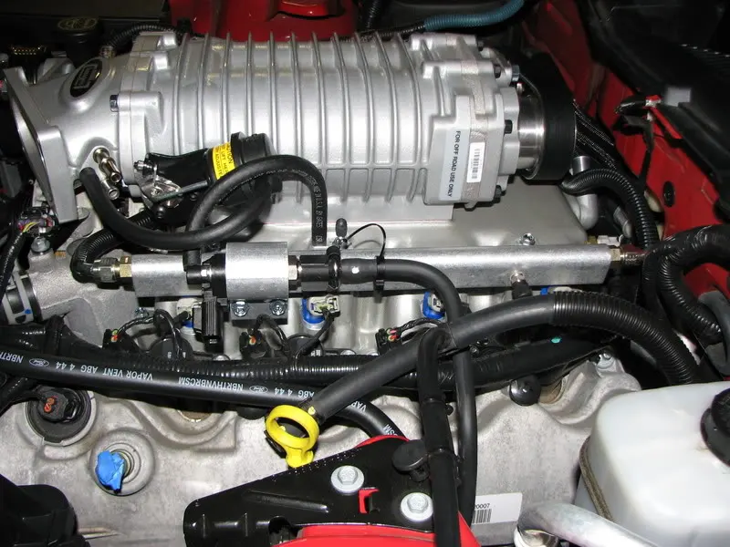

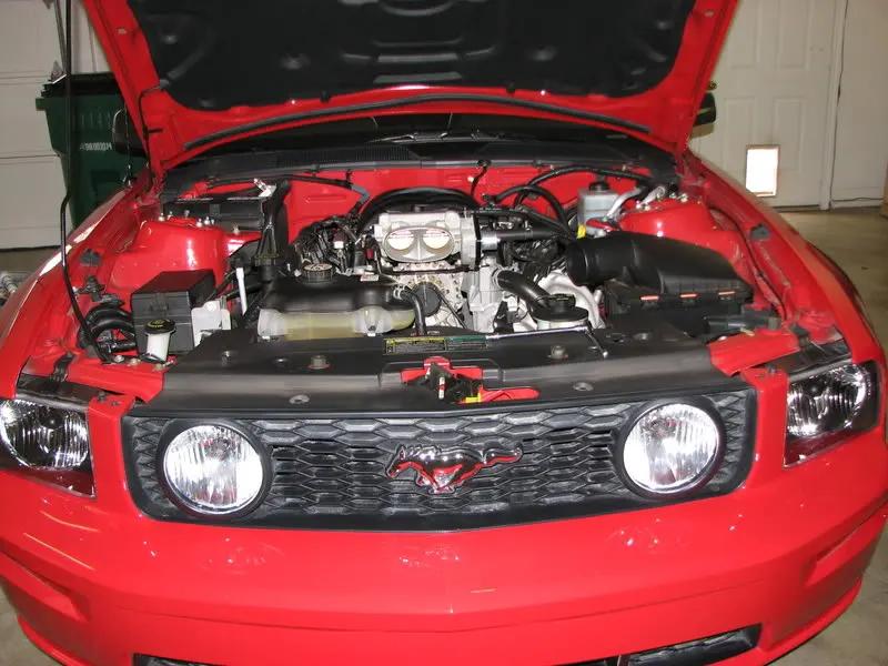

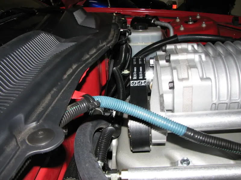

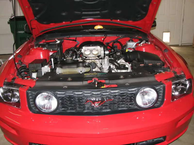

Here is the latest on the install. The toughest part was removing a steel line from the coolant crossover tube and drifting in a brass plug. Other than that, it was just following the directions. I'm biased, but I think it looks awsome on the car....
More to follow. Done for the night.

Done. The first start it did not even sputter. It fired right up no problems. I just got back from my second time out and it is basically the same car if you don't put your foot into it. When you get over about three grand on the tach....wow!
:jaw:
Basic mechanical skills and awsome instructions. Don't even hesitate, buy one; you will not regret it.

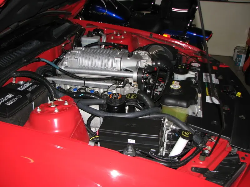

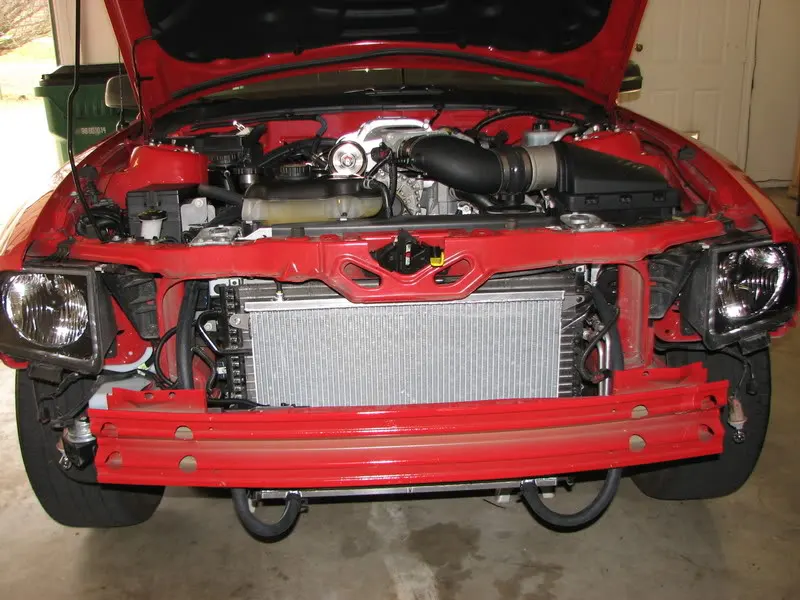

Intercooler installed.
Complete!!!

I put about 12hrs into the actual work....I stared at it a little while along the way though. I drove it a couple of more times today and it is the exact same car as far as starting, idling, and below 3500 - 4000 rpm as long as you don't push the go pedal too hard. I bet I could take you for a ride and you would think it bone stock. With that said, I have never driven anything like it when you are pushing hard and it is any where near the 4k range. PULLS LIKE A FREIGHT TRAIN!!! :D
I did some base line runs with my GTECH meter BEFORE the installation and got right at 260hp as measured by the device. (Multiple runs and averaged.) The number seemed reasonable on a bone stock GT. I also got a 5.3 second 0 - 60 time, but I am sure I could have beat that with a little more practice and a little lower tire pressure. (Balancing smoking the tires and a good launch is tough!)
I'll give it a couple more days of running then go do a comparison run to see what the difference is on the GTech meter.

2. The other is during installation; that the IAT sensor wires do not have to be stripped all the way back to the rear of the motor to splice in the new IAT. The supplied FORD wiring repair kit has plenty of wire and loom to reach all the way to the old MAF sensor location so you only need to strip back a few inches. That is one of the reasons I love this kit. Two wires is all that need to be modified to drop in the kit. All other wiring reaches with no problem. That is not the case with other kits.

Looking over all the installation progress pictures...I had to share this one. At this point during the installation is where you really start to question yourself about what you have done to your car.....:eek:
I had that same exact feeling as I was attempting to rebuild my motorcycle... I wrecked it and bent the frame. Bought a replacement frame and did an ENTIRE swap...wiring and all.

Do you have any more shots of the finished engine compartment? I would love to see some other angles. These would look great on there:
