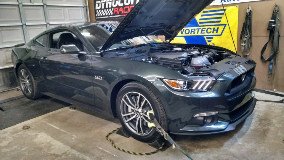

Lets start with the test subject:

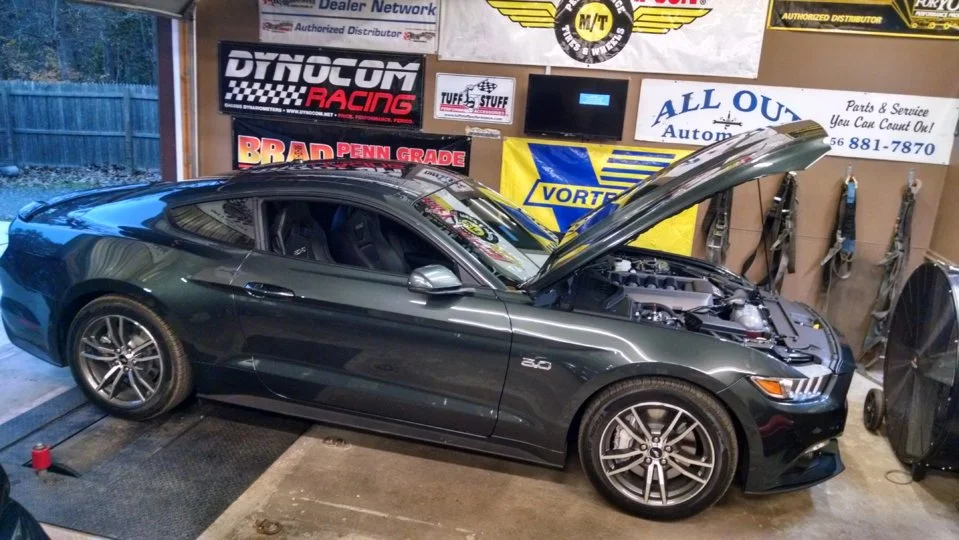

2015 Mustang GT Automatic
For base line testing we strapped the car down to the rollers with only 65 miles on the odometer. This car hasn't even seen a full tank of fuel through the injectors yet!

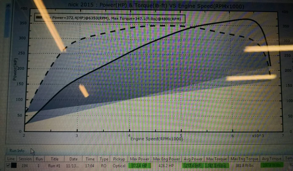

Our initial dyno testing proved that the Coyote engine is as stout as they say it is and laid down 372 RWHP and 347 ft/lb RWTQ through the automatic transmission. For the testing we are using All Out Automotives in house Dynocom Chassis Dyno.
Here are the initial results:

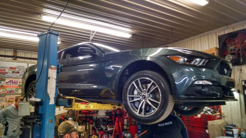

Now it's time to get down to business and get the car up on the lift for the install!

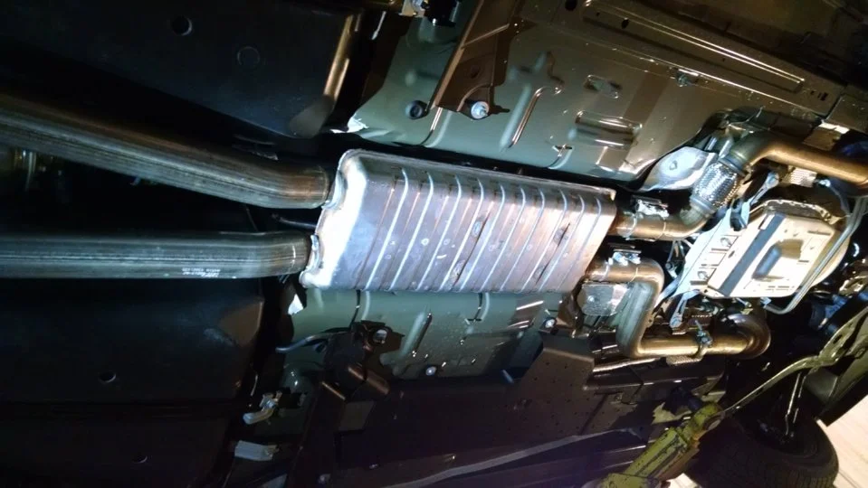

The factory exhaust has a huge resonator in the center of the car and big bulky mufflers. The car is very quiet from the factory and surly is missing that Magnaflow exhaust tone that every mustang owner has become so familiar with.
Here you can see the factory cat back system:
To remove the factory exhaust you need very few tools. There are 6 bolts holding 4 exhaust hangers in place and a ratchet with a short extension and an 13mm socket remove these easily. I will say that Ford engineered the hangers right, they have clips that hold the exhaust loosely in place even after the bolts have been removed. To disconnect the catback from the rest of the car you will need a 15mm socket and only need to loosen 4 bolts on the factory clamps to do so. With the help of a friend the factory exhaust is easily lifted down in one piece

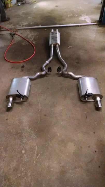

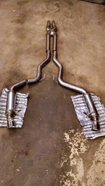

Now on to the good stuff. We layed the Magnaflow exhaust out to compare to the factory catback
Mandrel bent 3" stainless exhaust never looked so good. The quality is easy to see when you deal with Magnaflow. Perfectly mandrel bent tubing and beautiful factory welding. The polished mufflers and tips have a mirror finish that you can comb your hair to.

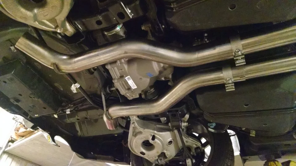

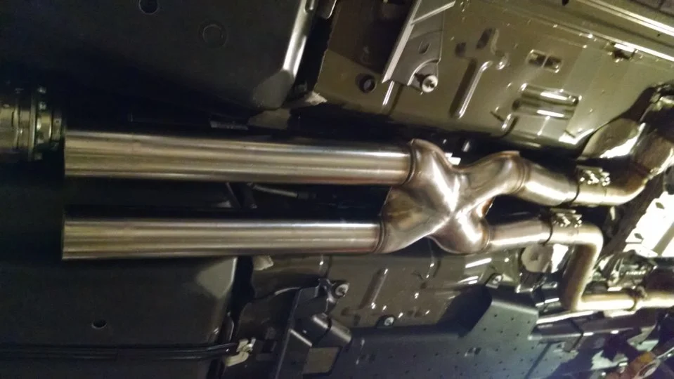

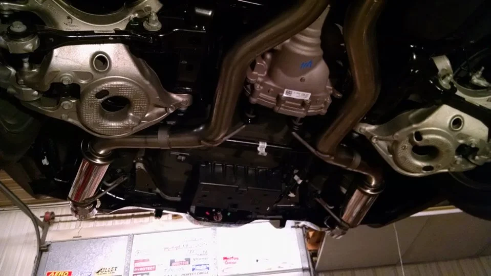

For the install we first loosely connected the new X pipe to the remaining factory exhaust re using the factory clamps. 4 15mm bolts hold this into place. Be sure to only snug these connections, the complete exhaust must be in place before tightening any connection completely.
Next we installed the intermediate exhaust piping and reinstalled two of the factory hangers. Magnaflow uses factory style band clamps that even have the same size nuts and bolts to make this install flawless!
13mm bolts hold the factory hangers in place as these are reused for your new exhaust system. 15mm bolts can be found on the clamps that will hold the intermediate tubing to the X pipe. Again, leave these connections loose until all of the exhaust system is installed.

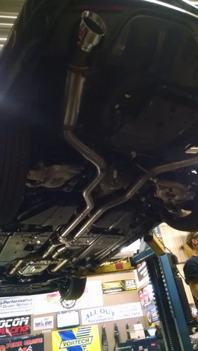

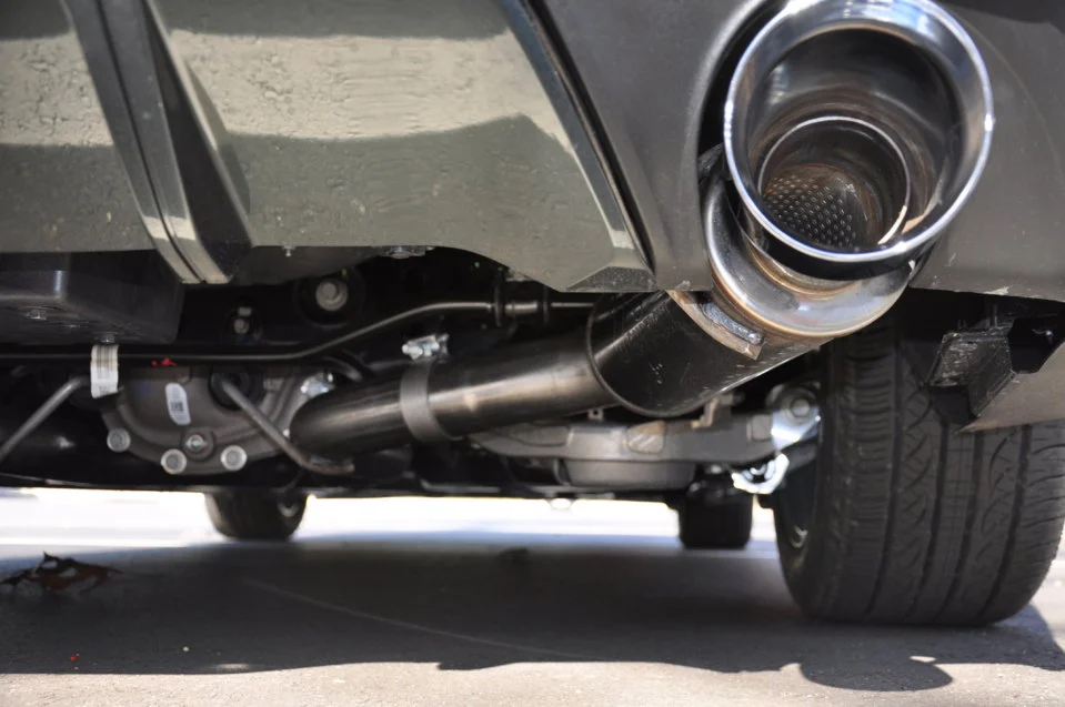

Now we get to the mufflers! Polished stainless steel works of art if you ask me. These things have a polished finish that is just brilliant! Reinstalling the final two factory hangers each one taking two 13mm bolts allows you to install the mufflers. Each muffler will require the use of the included factory style band clamp. These band clamps are again 15mm and really make this whole job a 2 tool project. Take a look at the mufflers installed.

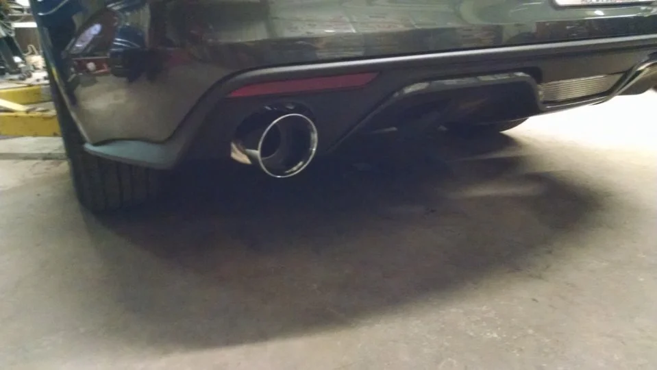

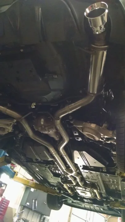

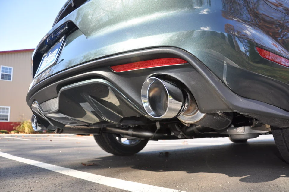

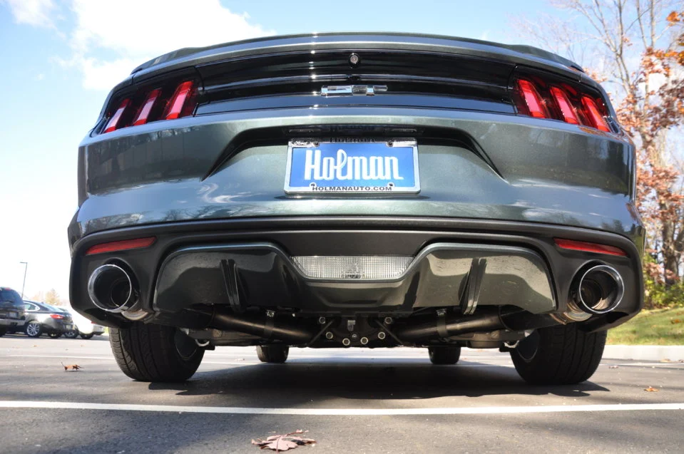

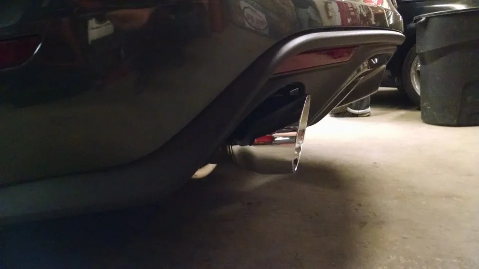

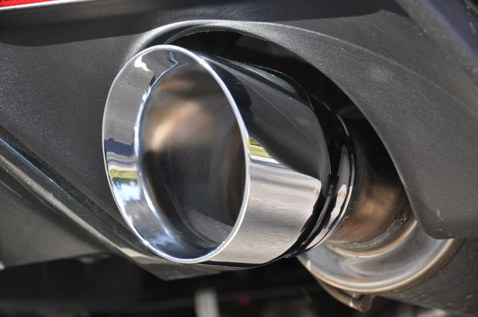

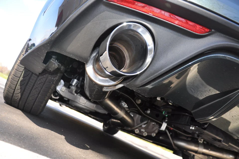

Now that you have everything mocked up into place you can carefully tighten all of your exhaust connections. This kit fit so perfectly that there was no adjusting to do! We simply started tighten the clamps in the front and worked our way back. This is the time to look at the 4.5" exhaust tips to see that they are centered in the exhaust cut outs and your on the home stretch.
Here are a few photos of the completed exhaust system:

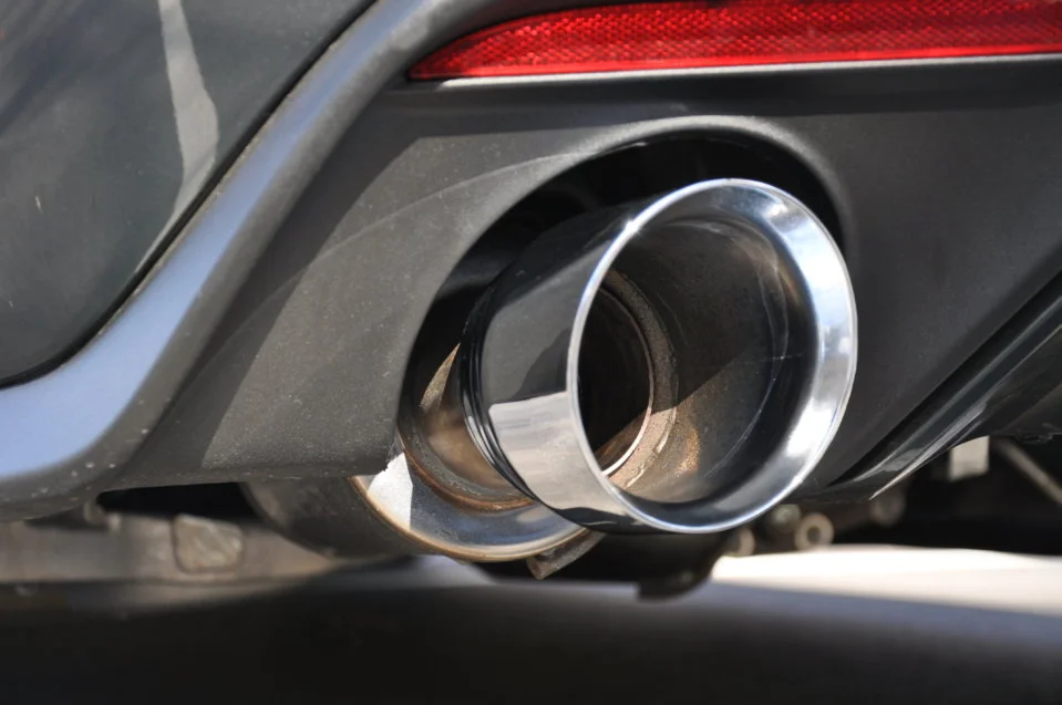

The tips fit perfectly!
The install time was less than 30 minutes and the guys at All Out Automotive made quick work of it. This system was designed with the end user in mind and can easily be installed by even the most novice car enthusiast. Please keep in mind that if you are doing this project at home you MUST use jack stands and always ask for a hand. Safety is key here, an ounce of prevention goes a long way!

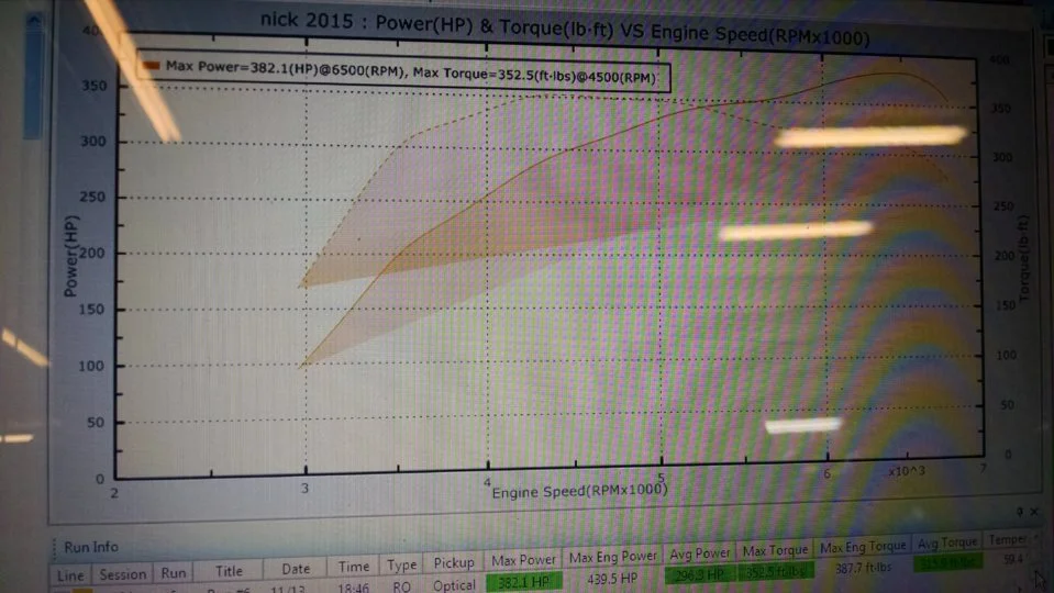

Increases in hp were apparent from the very first pull, we made a total of 6 dyno pulls to verify our results and they were all very consistent.
RWHP increased by 10 and RWTQ increased by 5.5 ft/lb's !!!

Where do you and Noobz get 20 rwhp from? Stock dyno run was 372 and after the exhaust install it went to 382, that's 10 rwhp! Stop drinking and posting :drink: Still a good gain though :nice:
Average power = 257.6 Dyno 1. It's the average over the entire pull.
Average power = 296.3 Dyno 2. So I was off. It's nearly 30 HP. lol
That's right about SOTP territory there.
So if you guys put your car on the dyno, what number would you report to us Stangnet'ers? The avg HP or your best peak HP number? :scratch: Even Nick reported 10 rwhp. Maybe I don't know what I'm talking about, I'm no dyno guru.
the peak is 10hp - but the avg horse power went up almost 30 across the whole graph . The peak is what we are most interested in but 30 hp avg diff is a big number
Doesn't really matter what you report. Peak numbers are great for comparing to a baseline. It's an immediate indication of improvement.
Average HP gain over the usable range tells you how much better it will perform. At the track and even more on the street.
It means that on average, across the entire run, there was a 30 HP increase. Not just the 10 HP difference at the very top of the usable range (who really runs up here that's not on a race track).
This response is spot on! Most people are interested in peak HP numbers and that is the reason for reporting them. I also provided the pre and post graphs so that they can be analyzed. The average hp gain is more than impressive and why the seat of the pants feel is there after bolting up the new system.
