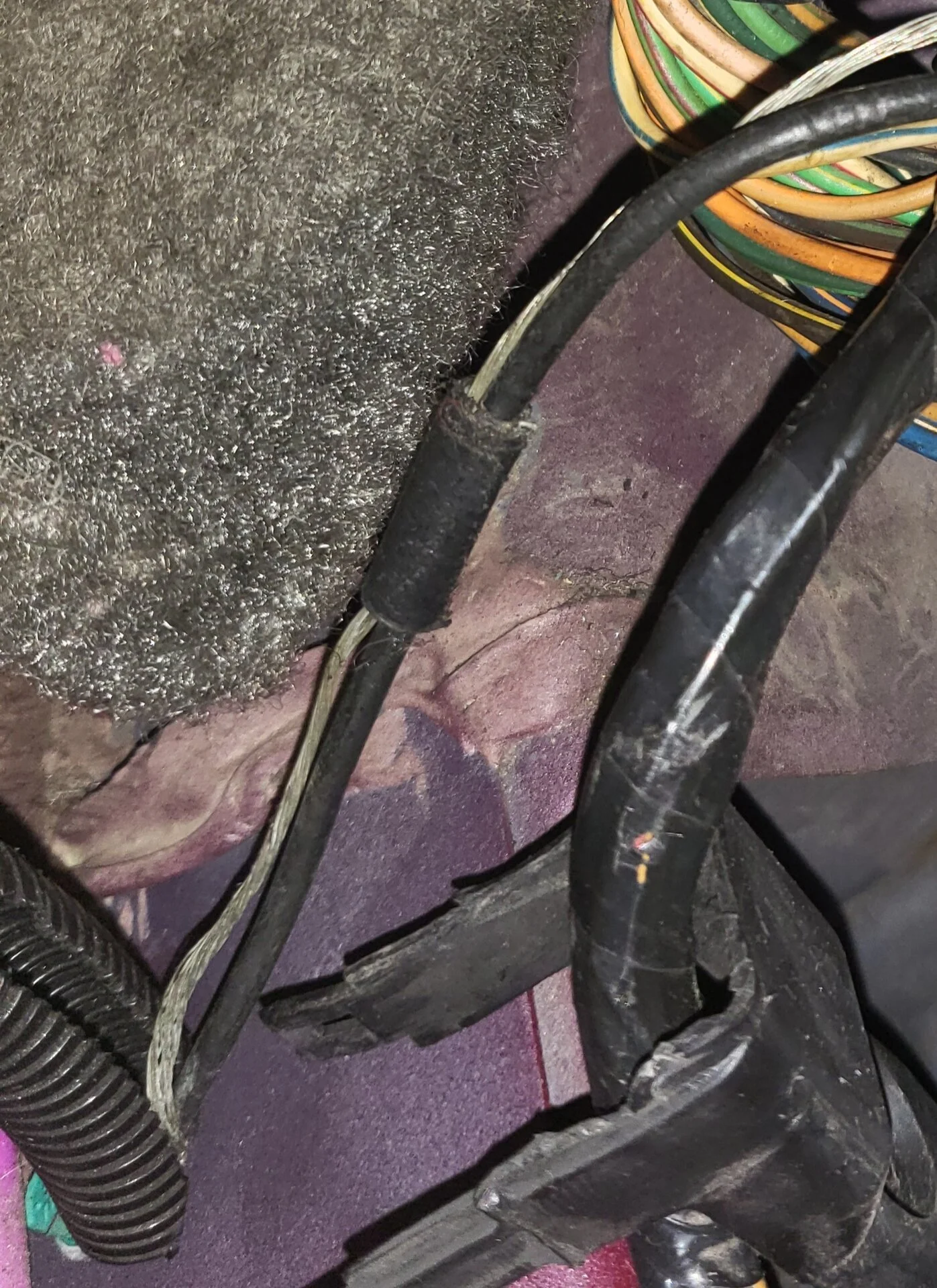

Hi. Have a question about my 1989 gt. I have owned this car since i was a teenager and trying to correct some of my mistakes. I found a wire that appears to be a ground for the main harness by PCM. Does this look stock from the factory to any of you? Appears as if someone spliced a wire in.
Hey Karthief, love your posts around here! Anyway, sorry forgot to mention, right by where the pcm is, passenger kick panel. I wouldnt have even noticed this but i swapped an a9p recently, and this looked strange to me.
Looks like the antenna wire. You cam see it through the gap between the door and fender. If you pull on it gently you should see it move.
