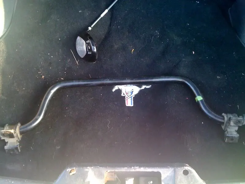

Best of all I picked up a sway bar today for $20.I included a picture. Does anybody know if it is a factory front sway bar or aftermarket
Will I notice a difference with the sway bar on as opposed to not being on?

Keep the work up, looks like aftermarket!

looks like a stock sway bar...they all got that green paint on them....spark knock is timing check it with the spout out

We got the sway bar on today. The car definetly handles better. It doesn't feel like driving a boat anymore. This weekend we will be changing the header gaskets and trying to set the timing. Thanks for the advice

looks like the stock sway bar to me.
you'll notice a difference, but if you're intending to build a car seeing a lot of strip time, you wont want that boat anchor...
