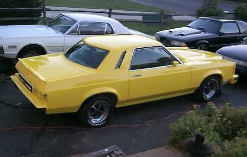

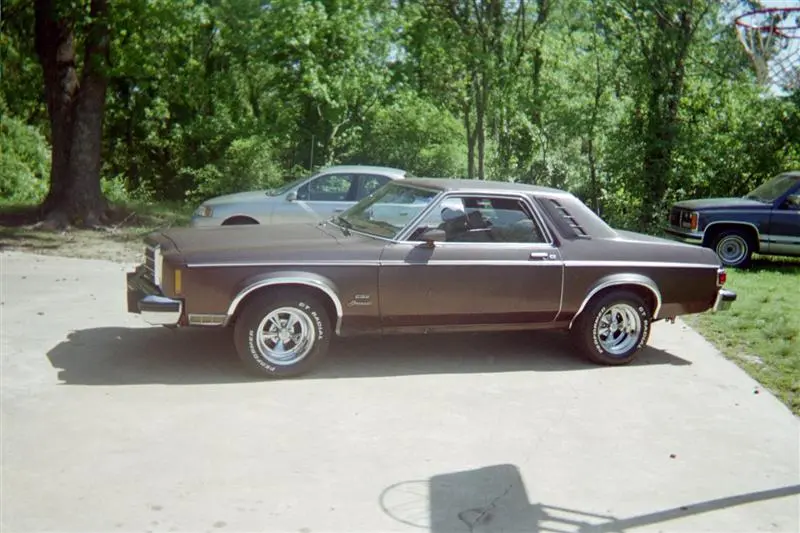

post some pics of the granada!!! i've always had a soft spot for granada's especially the ESS versions. i almost bought a 78 ESS from wrecking yard i worked at in high school. it was a 351 4spd car with ac, a sunroof and power seats. pretty cool car unfortunately they weren't able to sell it to me because of some stupid law that had something to do with the car being impounded and not sold at the police auction or some crap. too bad, because the body and interior were pretty much perfect. the paint was faded and someone had robbed the engine and trans. it even still had the 9" rearend (drum brakes)
here is one of my favorite granadas

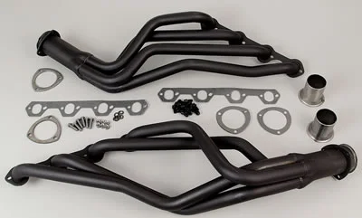

I have never had a Granada, but I know the Z-bar is much the same as Stang, Maverick, Cougar, etc...
If the driver's side header has 2 tubes run together high, and 2 tubes low, like in the pic, you should be fine.
That big open spot between the pairs of tubes is there for the linkage.

Bnickel, that yellow one is "kev's granada" i've seen it around on the net before, looks like a very nice car. I have a gallon of John Deere yellow I plan to paint my car with this summer, should be simmilar in color. I've got a half gallon of black as well, and plan to do a set of racing stripes. That's more than enough paint. I can't wait to get this cleaned up!
That second granada, the ESS is sweet. I'm currently running a set of 14" keystone classics, but would like to get 15's because nobody sells anything wider than 245's for 14 rims, that aren't drag slicks anyway...
...Yep, that's what mine look like. I should be golden then... Thanks!
