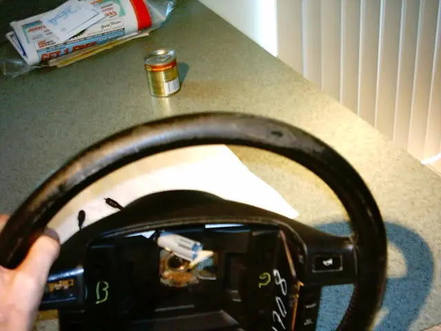

heres a pic of my wheel when it had a flaming river quick ratio, and 245's up front, it will speak for it self.
i.e. the whole!
